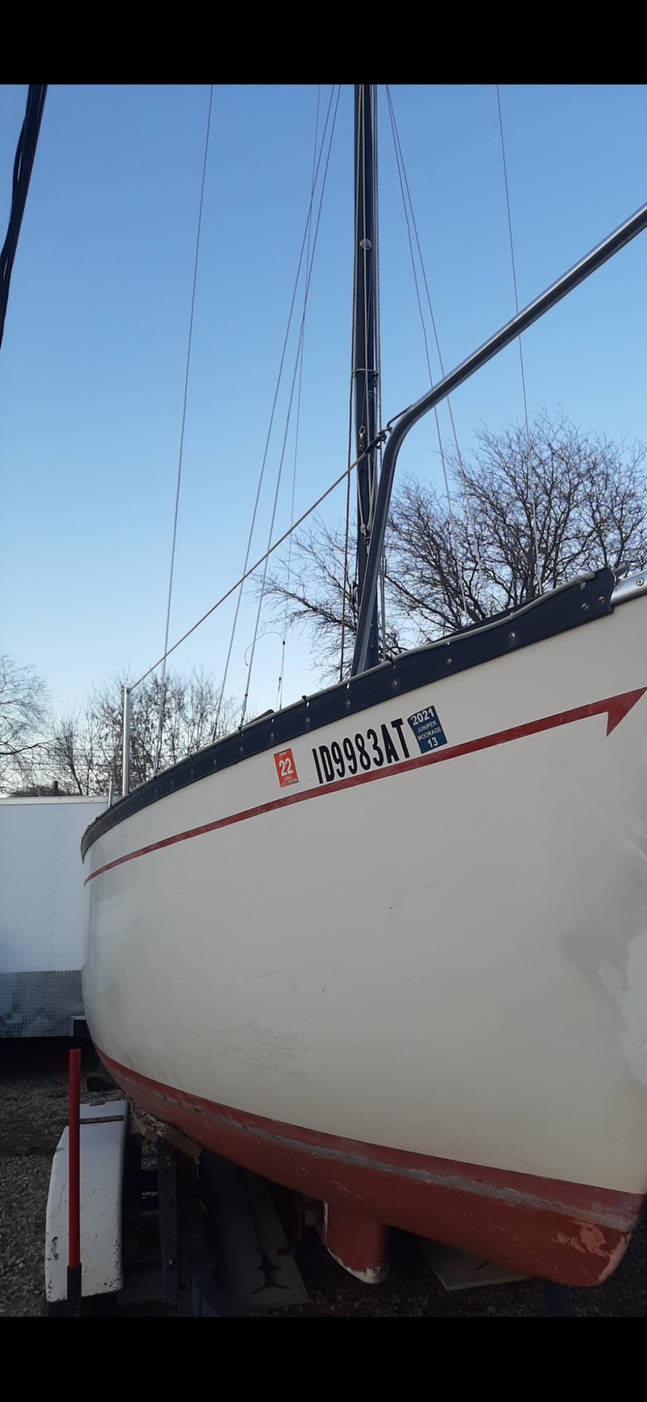

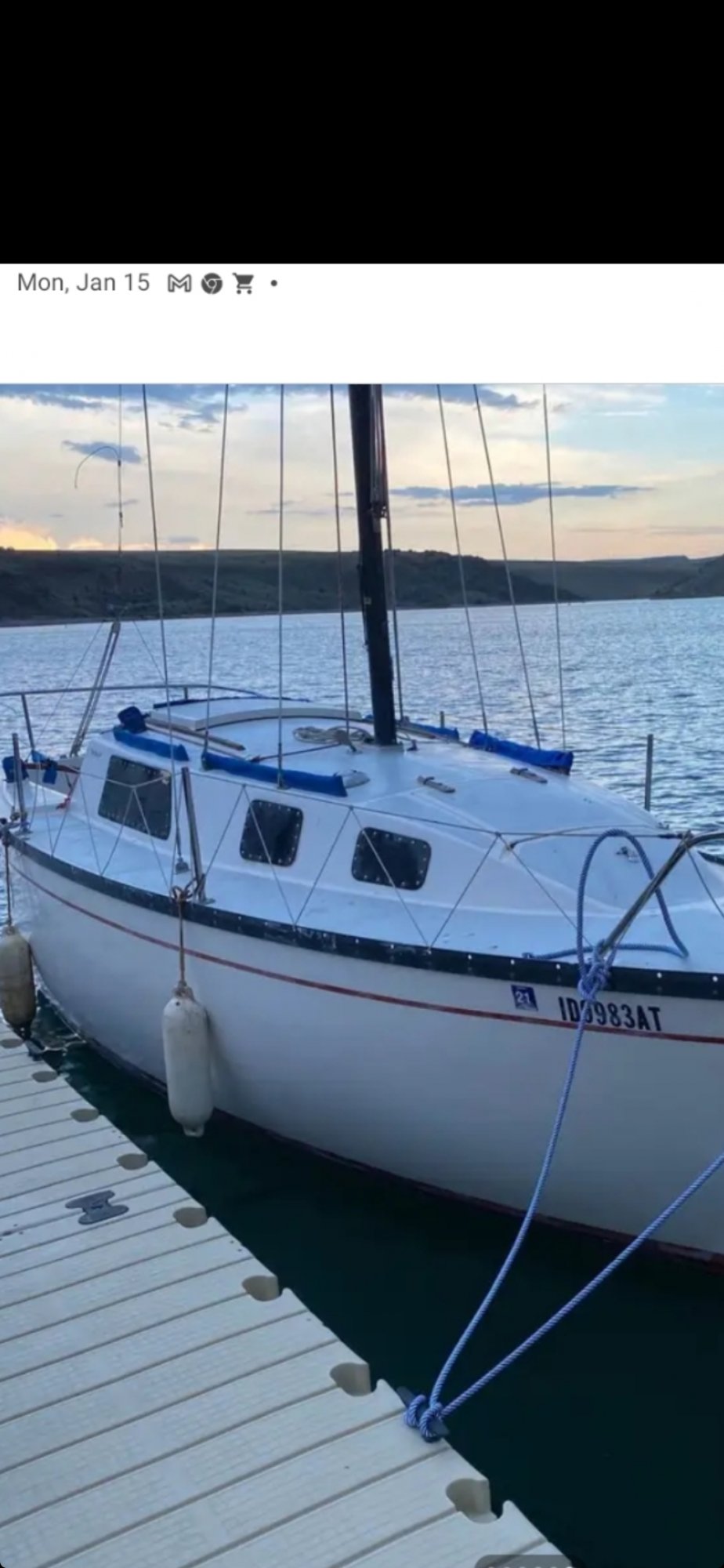

Hi there, I recently purchased a 1975 san juan 26 that needs a little gel coat repair on the hull. Does anyone know what hull color it is? Looks like off white. Or bone ??? Any help is appreciated.

50 year old gelcoat probably isn’t exactly its original color. You might be best off matching the color with fresh gelcoat.

Thank you all. I realize the match won't be perfect, just looking for what it might have been. It seems bright white is not right but maybe off white or something. Spectrum colors has nothing on this boat so it's pretty much just a guess from here.
