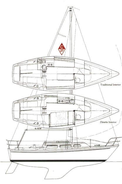

When the water is warm, you could dive and swim about the boat likely with out a problem. A plastic scraper and a scrub pad is fine. Note that your boat has a keel and it needs about 4 feet of water to be floating.
The shape looks something like:
Nudging it up into 4 ft of water will rest the keel on the bottom. You could walk about the boat and just lean under the water to get most of the boat clean. You could also use a brush on a stick to do most of the boat. You do not want to set the boat down on the rudder. They are not strong enough to support the boat.

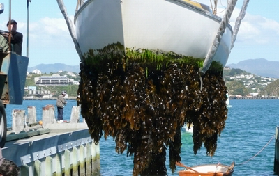

This is what a bad bottom growth looks like.
This would take some serious scraping.

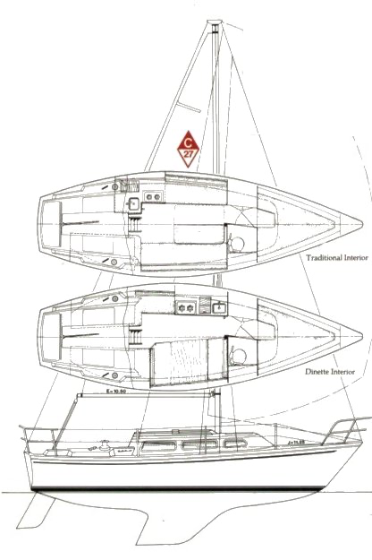

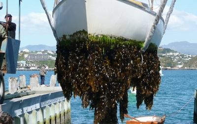

Looks like a mooring pendant I had to wrestle on deck in Maine once.
