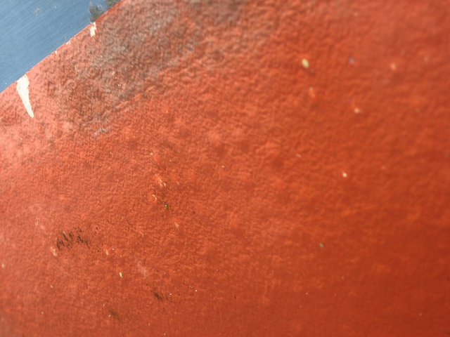

Here's a picture showing the blisters.
Id opine that those blisters are beyond the gelcoat and into the matting layer. Paint doesnt 'blister' like that .... and on three (maybe 11) of the 'pimples' it looks like white gelcoat is showing through, meaning the blisters are UNDER the gelcoat.

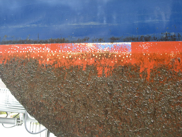

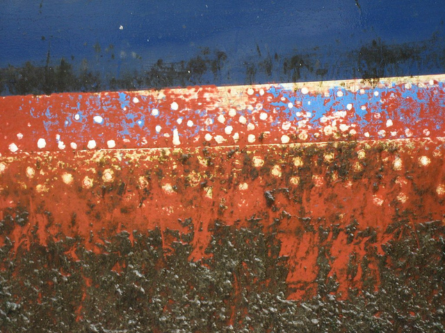

The boat had West Marine bottom paint applied last year. Do you know if the formulation would work in fresh water, or should a different paint be applied. And salt water can result in dirt, if not growth. See pics. (The boat was wintered at a slip in NY and not used most of last season.)

As for whether the existing bottom paint will work...no way to know without knowing which WM knockoff it is. But judging from the amount growth that's attached to the hull, it seems to be about worn off anyway.
