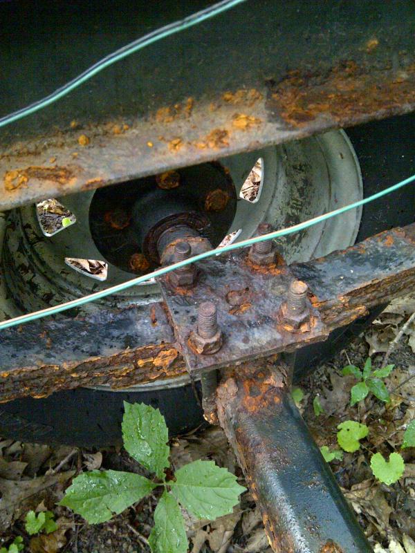

I've never seen a bearing buddy with any type of fastener. The usually just drive in. Is it possible the PO pulled the grease fitting out and put a thumb screw in its place? Post pics

My question is "Is it really a bearing buddy?" So, yeah, dawg, post pictures. I might even learn something new.

My Bearing Buddys throw grease. I think I just haven't found the sweet spot for filling them. I'm going to lay off the grease for a bit and clean the rims again. I'll let it go until it stops making a mess or until they need grease.
Here is a pic of one of my hubs and rim. That all from a 4 hr drive at 100km/h. Messy.
