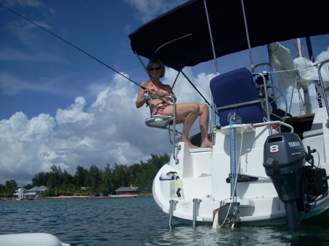

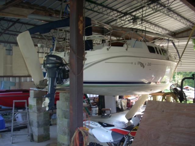

I bet your buddy wants to help you get rid of that 9.9 yam w/pwr tilt. The motor on my 260 is listed as '04 8hp yam/4stroke/high thrust/long shaft/elec tilt/pedestal control but it's virtually the same size/wt motor which is now designated as a 10hp. http://www.outboard-engine.com/enginespecs.php?recordID=200 I have over 1k hrs on it and wouldn't trade that elec start/tilt for ANYTHING.
If it's newer than 6-7yrs old, it's a great motor design. Unless it's physically larger or older than the link or motor pic below I'd look elsewhere in the boat for your weight distribution problem.
Good luck in your new boat. Mike
