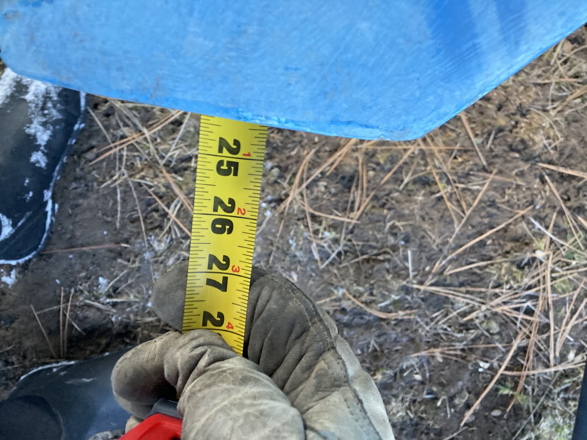

New boat and old trailer for a shoal draft but I need to mod supports to allow for width of wing...est. 18" but was hoping someone knew for sure

Mars metals in Canada fabricated your keel. Suggest that you call and ask them. Otherwise, I suggest reaching out with yours question in hunter small boats.
However, you want the center of the keel, not the wings, on the keel tray if memory serves me correct for the weight of the boat to sit on the keel tray
make sure the keel sits on wood to prevent any sliding

If its any help, my H326 Wing Span is 33.5" (tip-to-tip).

The bottom of the Hunter keels are not flat like Catalina keels. If a large amount of weight rests on the hunter wings, the possibility of the wings can bend and/or break off. I replaced a few of as is dealer
