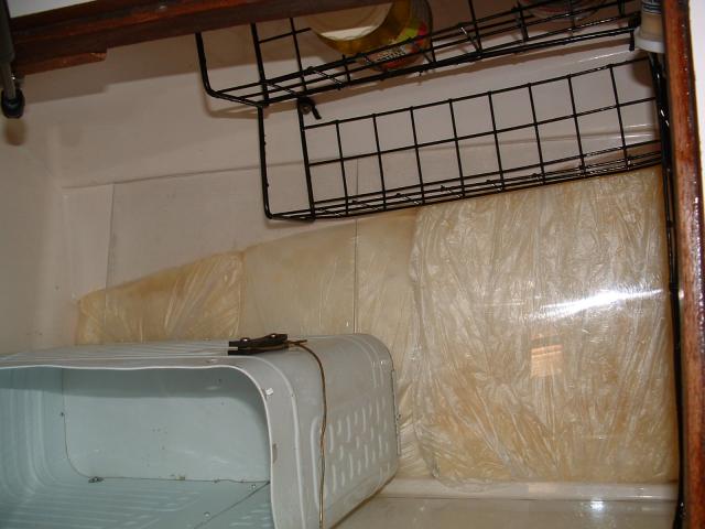

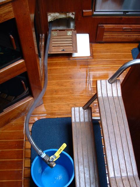

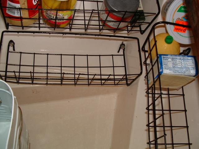

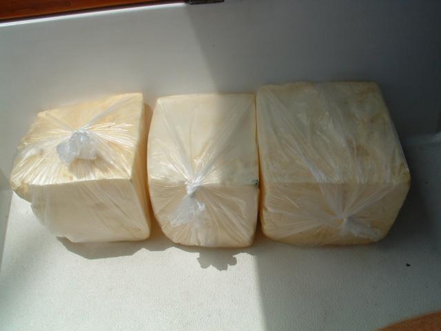

Well, the insulation sucks
so I wouldn't count on it for a deep freeze, but it can work. I've had a cheapy 12 volt air cooled Grunnert running ours for 10 live-aboard years.
Also, be prepared for a real science experiment in your bilge if ANY organic particles drain in there.
Here's some pics of what I did.
