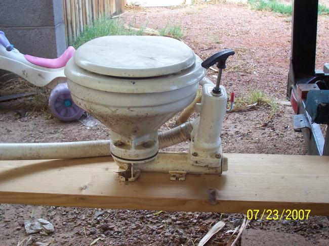

I'm replacing this old thing and due to the age of my vintage boat (1968)i don't have a holding tank *pop so I'm opting for an msd porta potty BUT how well do they seal at a 30deg+ angle *yks ? I don't sail for more than a few days at a time so i don't see cutting holes and installing a tank on something i don't need a trash bag full of saw dust works for me but mama says ***-!! lets just say she's not fond of that idea at all
