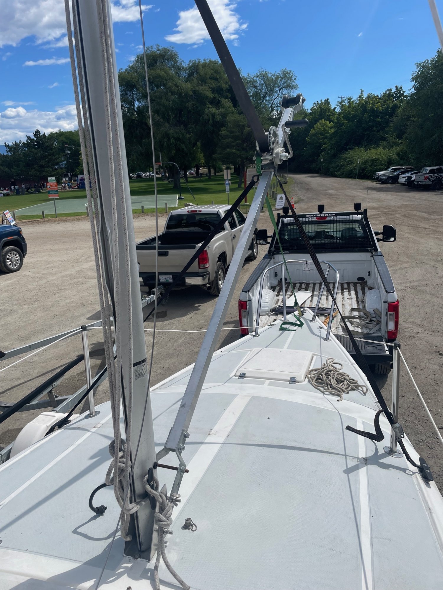

I thought I would post a picture of what we use to step our mast. It works so slick. Michelle cranks the winch and I physically hold on to the mast and keep an eye on everything. We will stop about halfway or so up and look, then again at 85% up to check on shrouds and backstay. A few cranks and were locking the forestay. Very slick.
Last night after a great day. Michelle was cranking the winch slowly down and I said, "sweetie, we're done". She was shocked and very pleased.

Very nice! In some ways I like that better than the system I made for the Mac 26S we used to have. It's definitely simpler.
