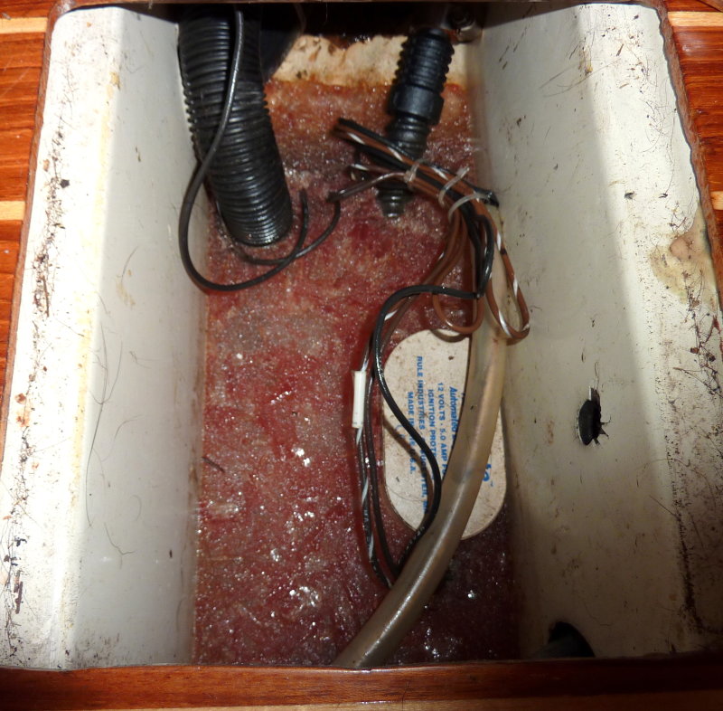

Unfortunately there is no good way to deal with this, in an area that freezes. Here in Maine I have seen countless bilge pumps with blown fuses or oversized fuses and the resulting melted / fried pump due to the bilge water freezing, even with PG in it. I got a call from this very panicked live-aboard one winter. I measured the sea water temp at 28F, it had been -10F or colder for about 4 days, and the -50PG he'd filled the bilge with had become diluted and froze .... Even with an on-board temp in the boat of 65F to 70F his bilge was frozen solid. Because he replaced the fuse when it blew, with the wrong size fuse, when the bilge contents finally melted the bilge pump was dead......
