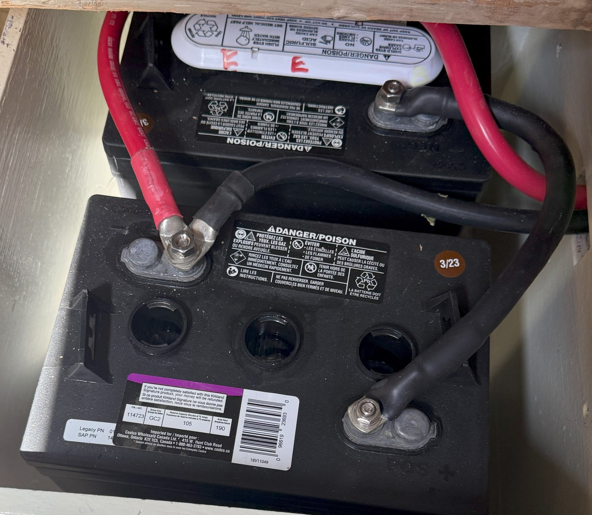

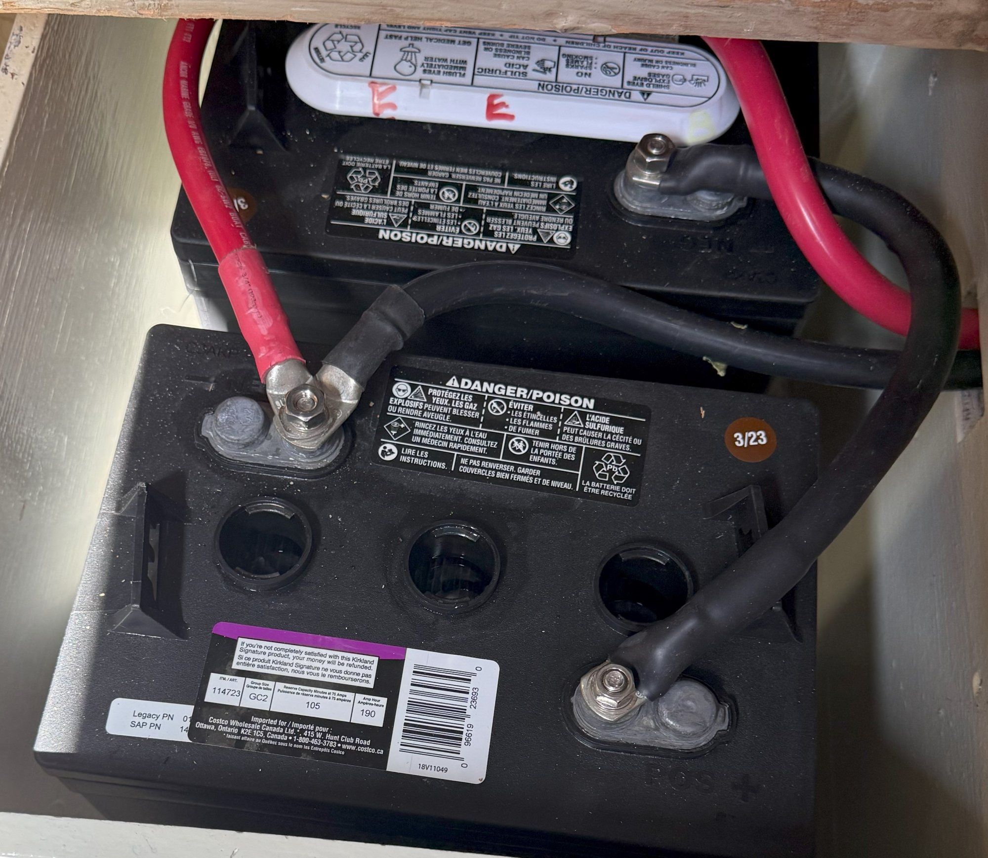

AhHa!! OK first off, I see a mistake I made on my wiring diagram with respect to the battery capacity. I found a photo showing the tops of the batteries. So I should be using 3 pairs of 190Ah each, making for a total factory capacity of 570Ah. I guess if I take away roughly 30Ah again from that to account for decreased capacity with age that would give me about 160Ah.
From looking online, the Kirkland GC2's seem to come in a few different specifications. I see 190Ah, 208Ah and 205Ah all listed for the product. Even though all have the exact same item ID number (114723). Mine have 190Ah on the sticker. Attached is the pic I found from when I was recently checking the water levels.
