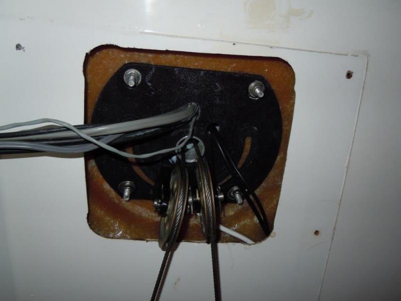

I was able to get underneath the pedestal on mine and drill a new hole through the aluminum. I used a 3/4" hole saw, but heard others use a spade bit. You can see in the picture the hole with the black wires going up for my new autopilot and gps. That hole was needed as all the others were full up. Wear safety glasses as all that aluminum falls right in your face.
You are so lucky to be able to get under the pedestal. Me not so much. There is a lower level of the deck that opens only into the cockpit. Which is part of my problem. I can't see under at all, my only other hint is trying peer down from the top of the pedestal with a flashlight.
But still an option is to take the pedestal off, but my experience with dismantling is that you often find or create fun new problems when you do that. But.....
