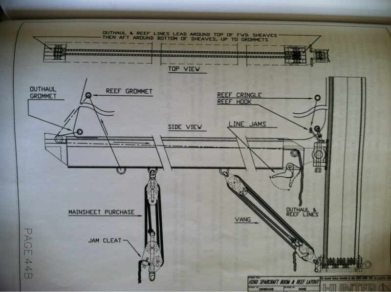

I have the same question. I took my mast and boom apart in 2007. My pictures were not good enough. I remember saying "oh that will be easy to put back together". NOT. The manual shows a very nice picture of what the sailboat would be wired like and what it would look like from the side if I was 40 feet away but nothing of how the running rigging goes in the mast and boom. I have a 33 foot Hunter though. Any help would be greatly appreciated.
the manual can be seen under boat specs, pull up the 260 and scroll down until the one opens up with the manual and there is a lot of information to be gleaned. After that, get back with us as this is the proper forum to ask questions.
