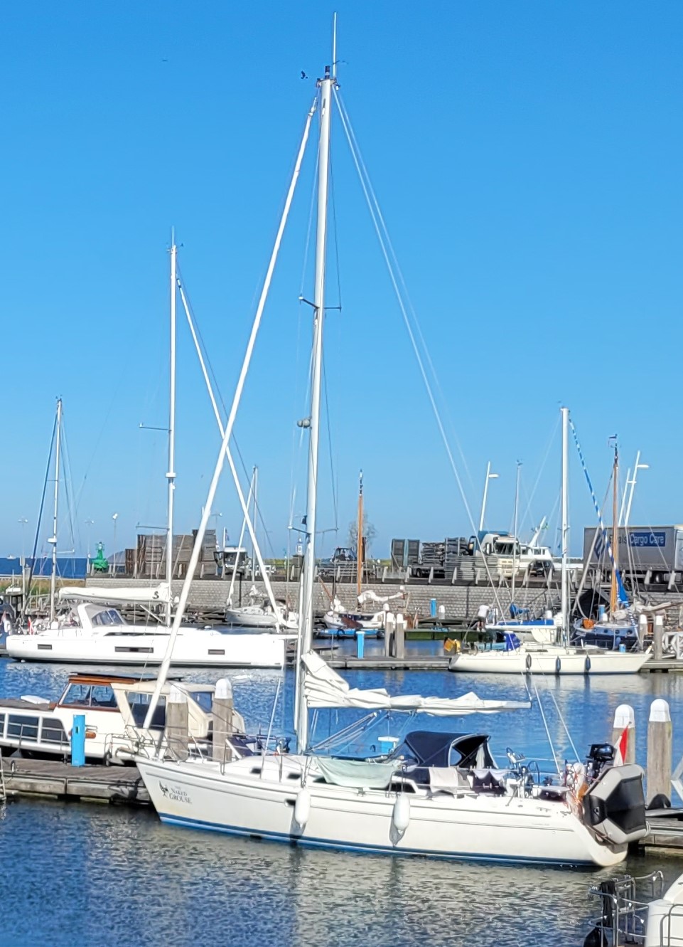

Has anyone rigged davits or a suspension system off the transom of a Catalina 28 for a dinghy? If you have a picture that would be awesome. We have the swim deck and ladder.

If the dingy is hanging on the stern as the pictures show how would you get back on the boat when you fell or jumped off without first preparing for that?
