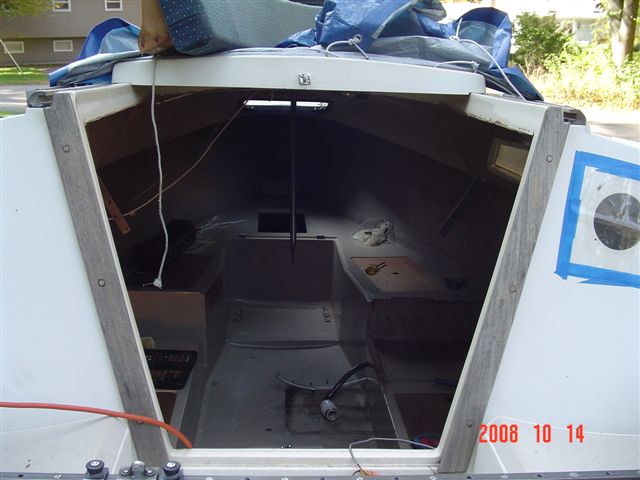

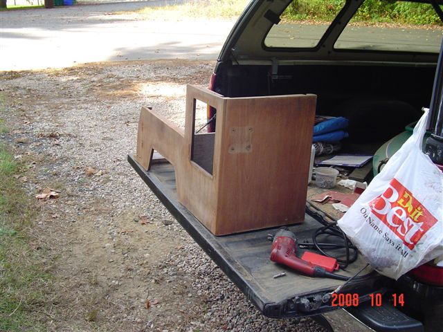

Here are some pictures of mine along the way. I just finished ripping out the last of my liner this past weekend. I now officially have everything out of the interior that's coming out. I already have nearly identical liner ready to go back in. Got it from yourautotrim.com Decent price, but not as cheap as some alternatives. I just ordered the book Trinnka recommended, so hope to start putting stuff back in soon.

Dodge,
That main bulkhead along with the galley cabinet can be removed very easy. When I removed the center post, I left the cross piece in tact with it. If you can remove all the bulkheads from the cabin, that whole job will be easier for you. The stern bulkhead might give you a little trouble, but it can be removed.

Trinnka, it's all out, has been for a while now. I just had those old pictures available. I'll try to take some more progress pics this weekend. You redid your bulkheads, didn't you? How many sheets of ply did it take if you did?
Dodge,
All I did was stain the wood and varnish it. All my bulkheads were in good condition. I liked the dark red Mahogany color that Chuck "Lucky Bum", did in the cabin of his boat "Get Away," so I did mine the same color. Right now, I'm working on my mast.
