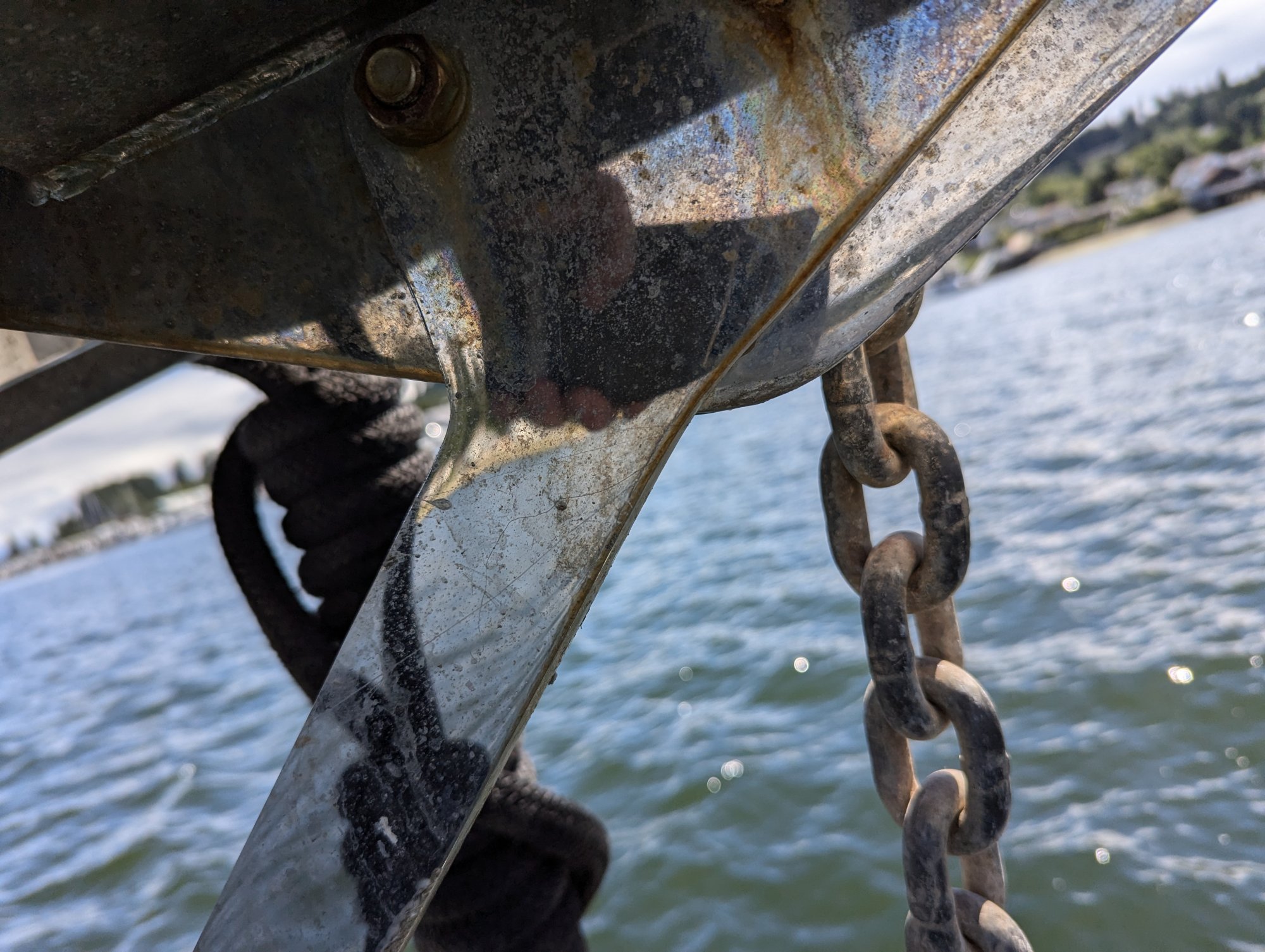

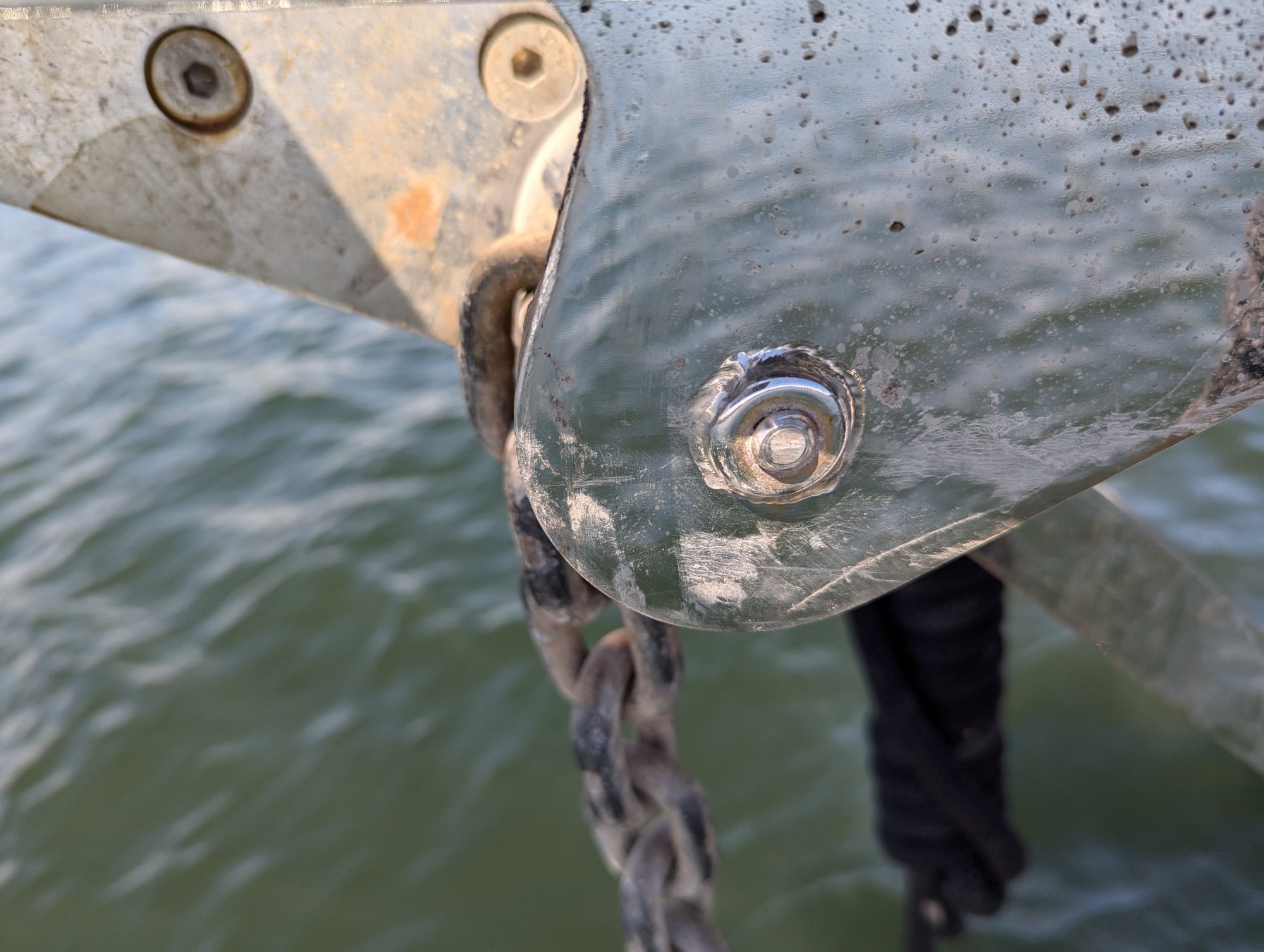

On my '14 Beneteau Oceanis 55, the lower anchor roller needs replacing but I don't know how to properly remove it. What are your suggestions salty dogs?
Pictures are shots on either side of the roller needing replacing. Intent was to replace it while at anchor but it appears to me that I'll have to hack it off or completely disassemble the bow sprit to see what's on the other side of plate in the second photo.

It is hard to see from the photo, but if I may guess, it appears that there is a hex nut from one side and the opposite side it is a bolt head similar to carriage bolt head. Perform this repair at the dock, hang a tarp below this area to catch any loose parts, then remove the anchor and remove the hexhead nut. The bolt will slide out of the opposite side.

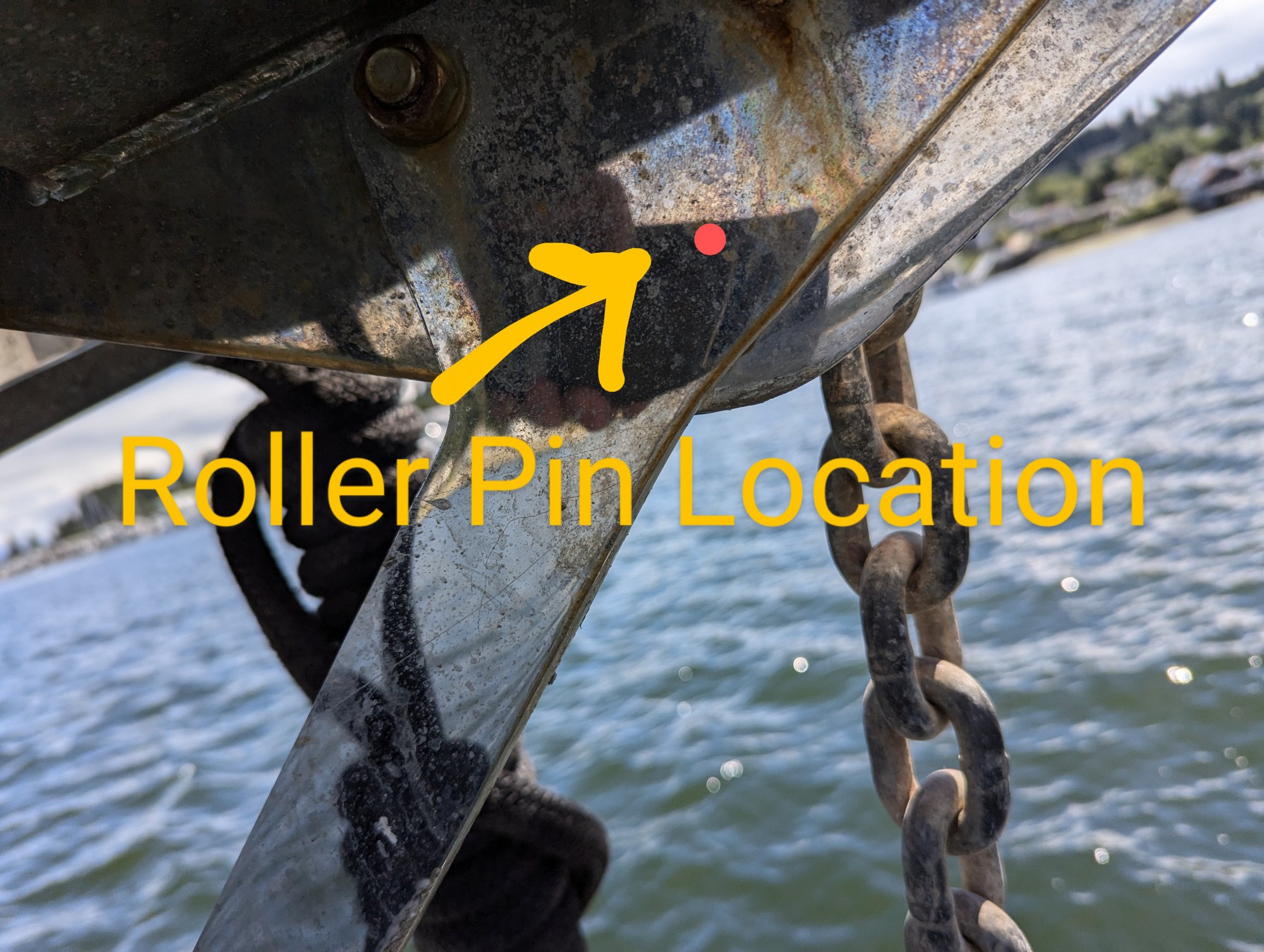

Here is the approximate location of the center pin on the opposite side of the welded cutoff nut side:
Maybe there is a flat hexhead bolt fastened into this side?? I would have to remove the center brace support first of course, fastened with a few bolts to the bow sprit and to the from of the boat... It's a really weird design. Thank you though for your comments!!

Solution: You have to remove the vertical brace to expose the bolt head. Super annoying but I guess the bolt will never work itself out!
