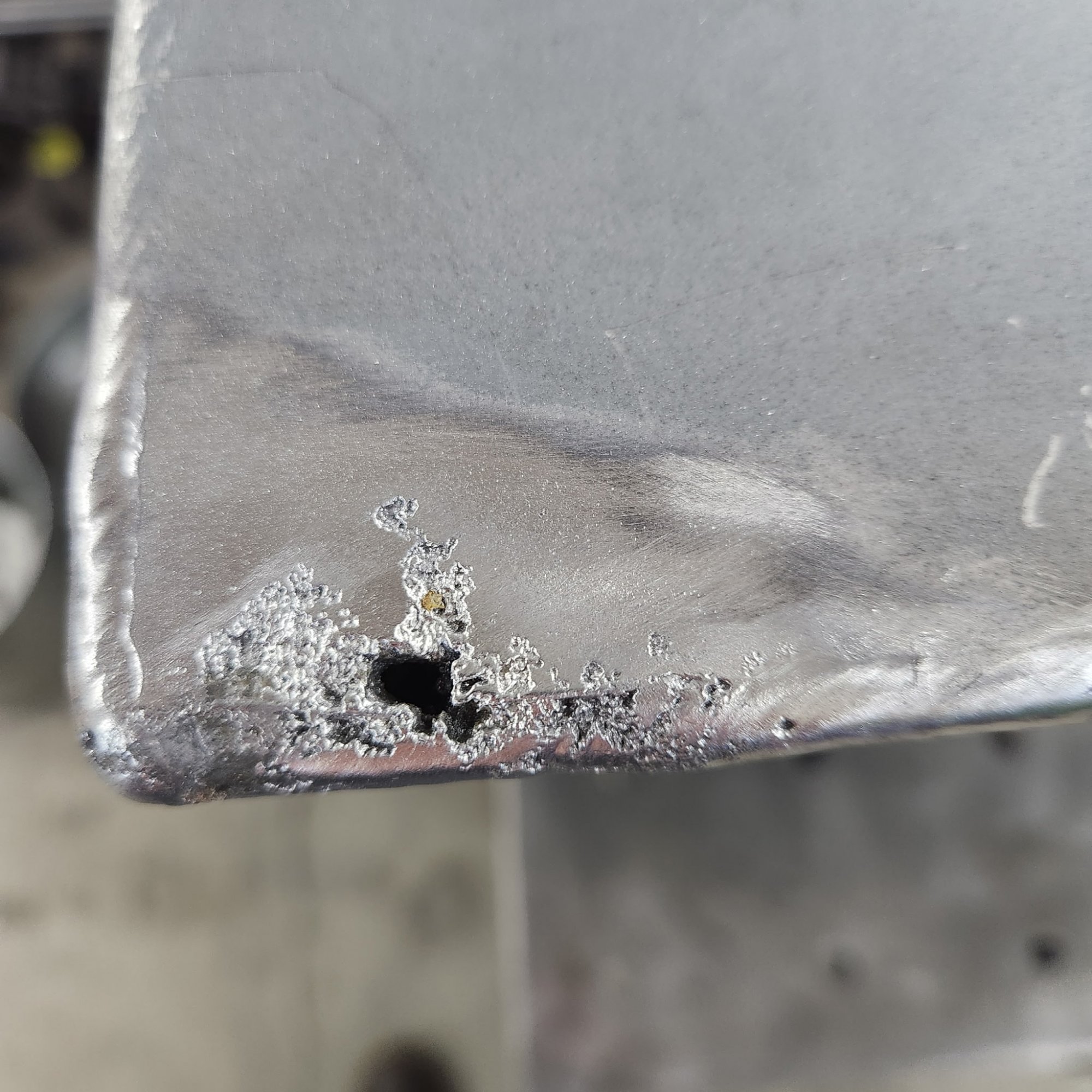

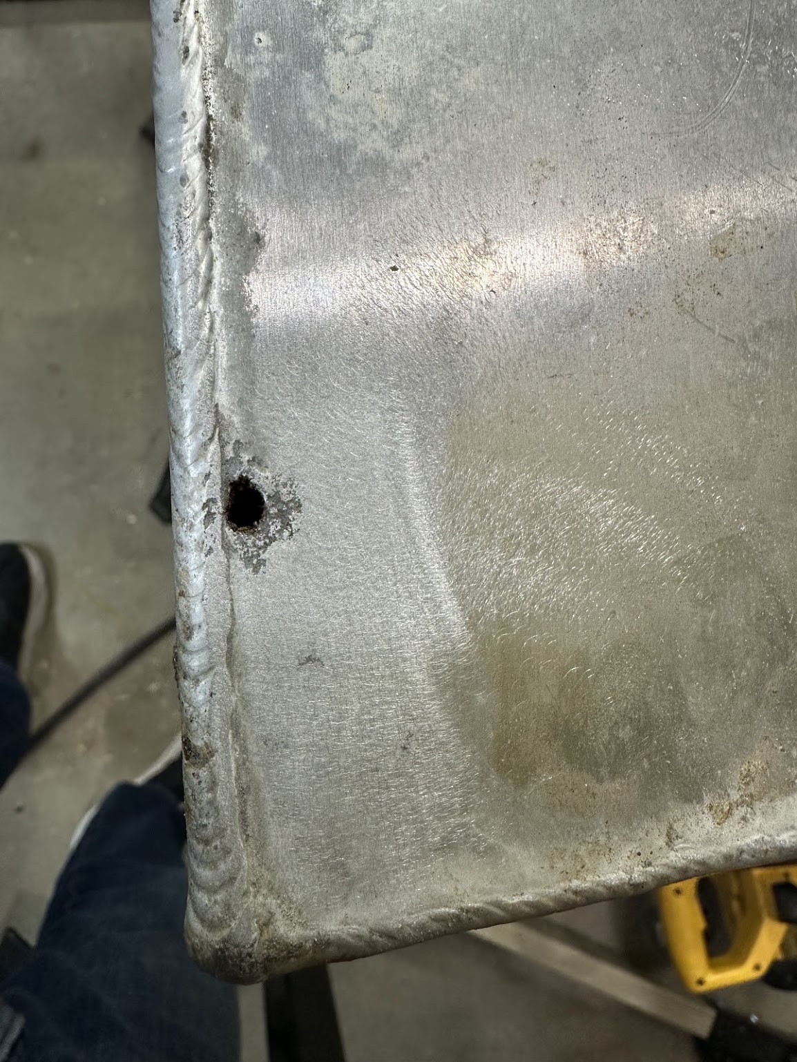

Once I got the tank out, I learned that a gentleman in my yacht club was a fabricator experienced in tank repairs. After removing the paint, he quickly found the problem. This is on the front edge of the tank, on the starboard side, closest to the deepest part of the fiberglass pan where fluids pool:

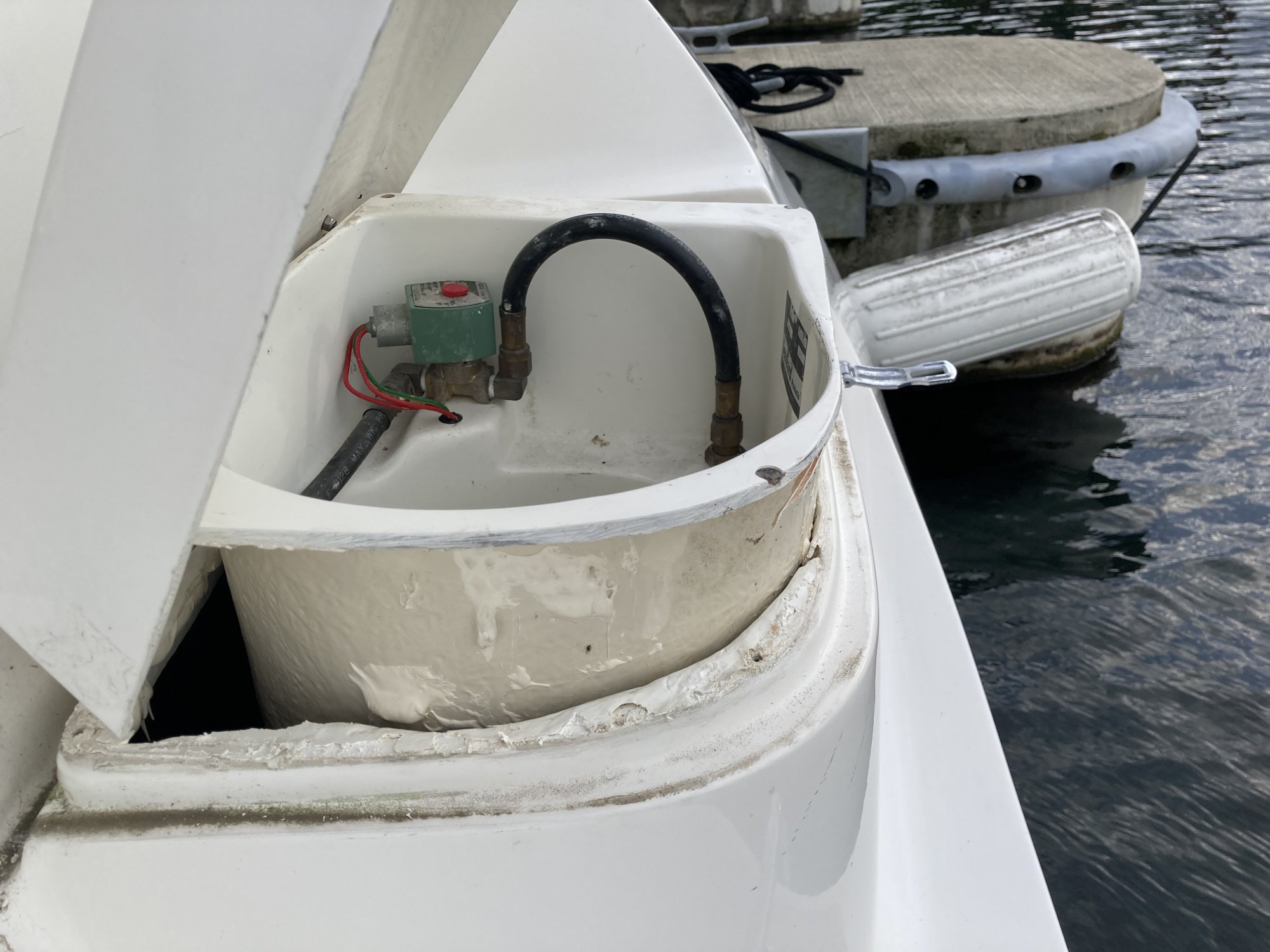

Step 3: Loosen and lift the propane locker liner.
The starboard-side cylinder-shaped propane locker protrudes down next to the fuel tank and will be prevent removal. The good news is, the inside of the locker is a drop-in liner, not molded fiberglass. Remove the propane tank, remove the 4 screws that hold in the liner, and work to break the sealant that seals the liner to the boat. I was able to break it by running a razor knife through the sealed seam, and then pulling like hell until the liner lifted out. I did not have to disconnect the propane hoses or wiring for the electric valve. I simplify lifted it a few inches to make remove for the fuel tank to come out.
This was enough lift for the tank to clear:

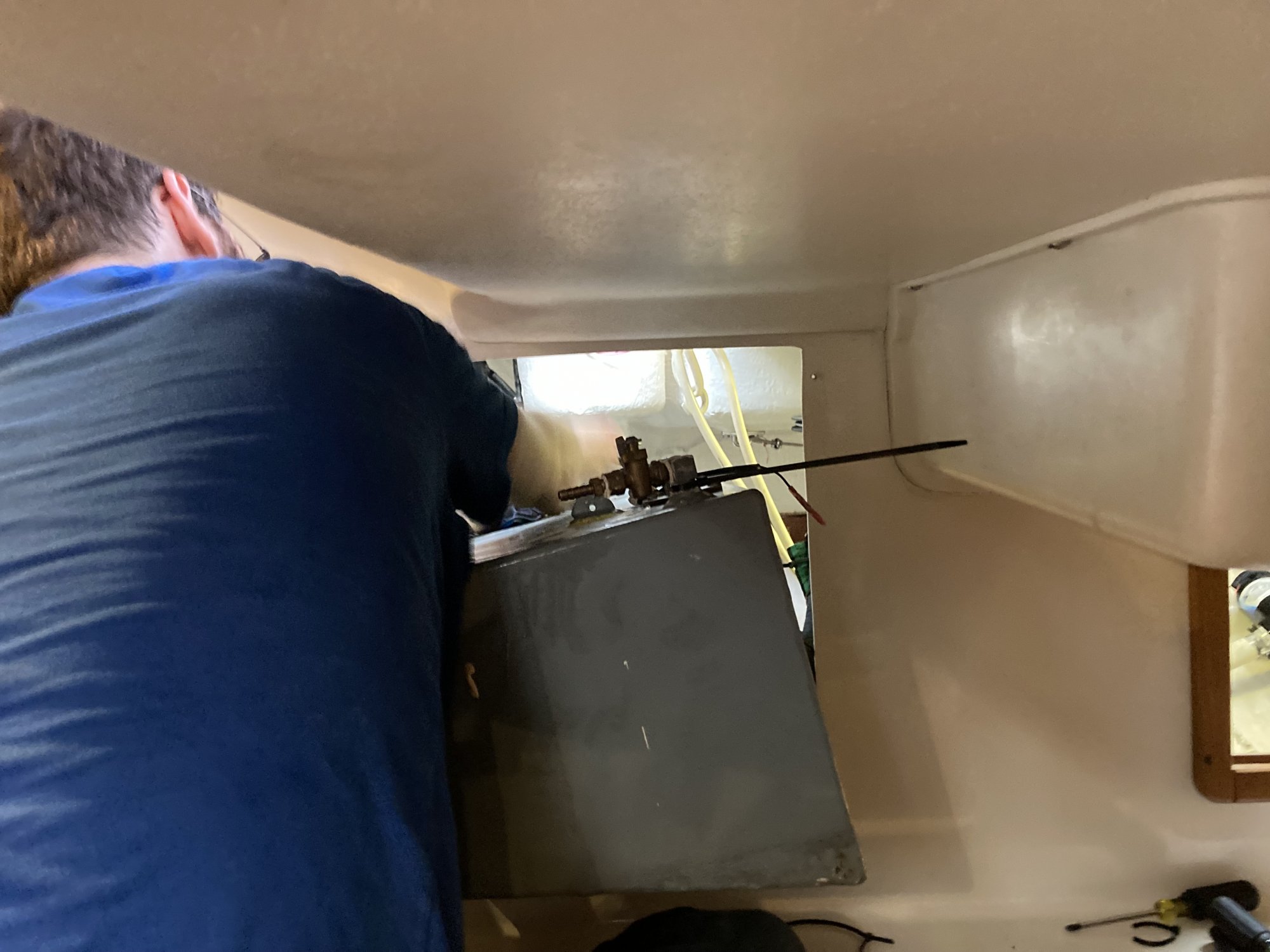

Step 6: Remove fuel tank.
After that prep, which took around 3 hours including the time wasted trying to get the tank out the other way, it was surprisingly easy to get the tank out. Mine was 1/2 full of diesel, and I actually removed it with the diesel in, using a rubber plug in the fill hole. In hindsight, it would have been worth the time to disconnect a fuel line up by the engine and let the lift pump transfer the fuel into jerry cans. Nonetheless, we lifted the tank out of is pan, rotated around the rudder post, and up onto the water heater platform. It's full width fits through the opening, but it needs to be turned on its side to get out of the aft birth.
This was a happy moment:

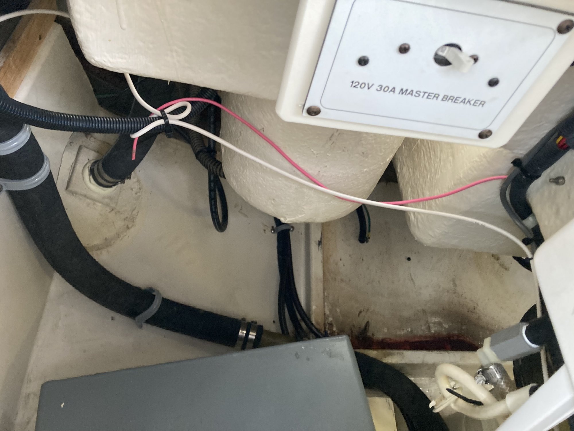

Here's a view from the cockpit. Note where all the leaked diesel pooled.

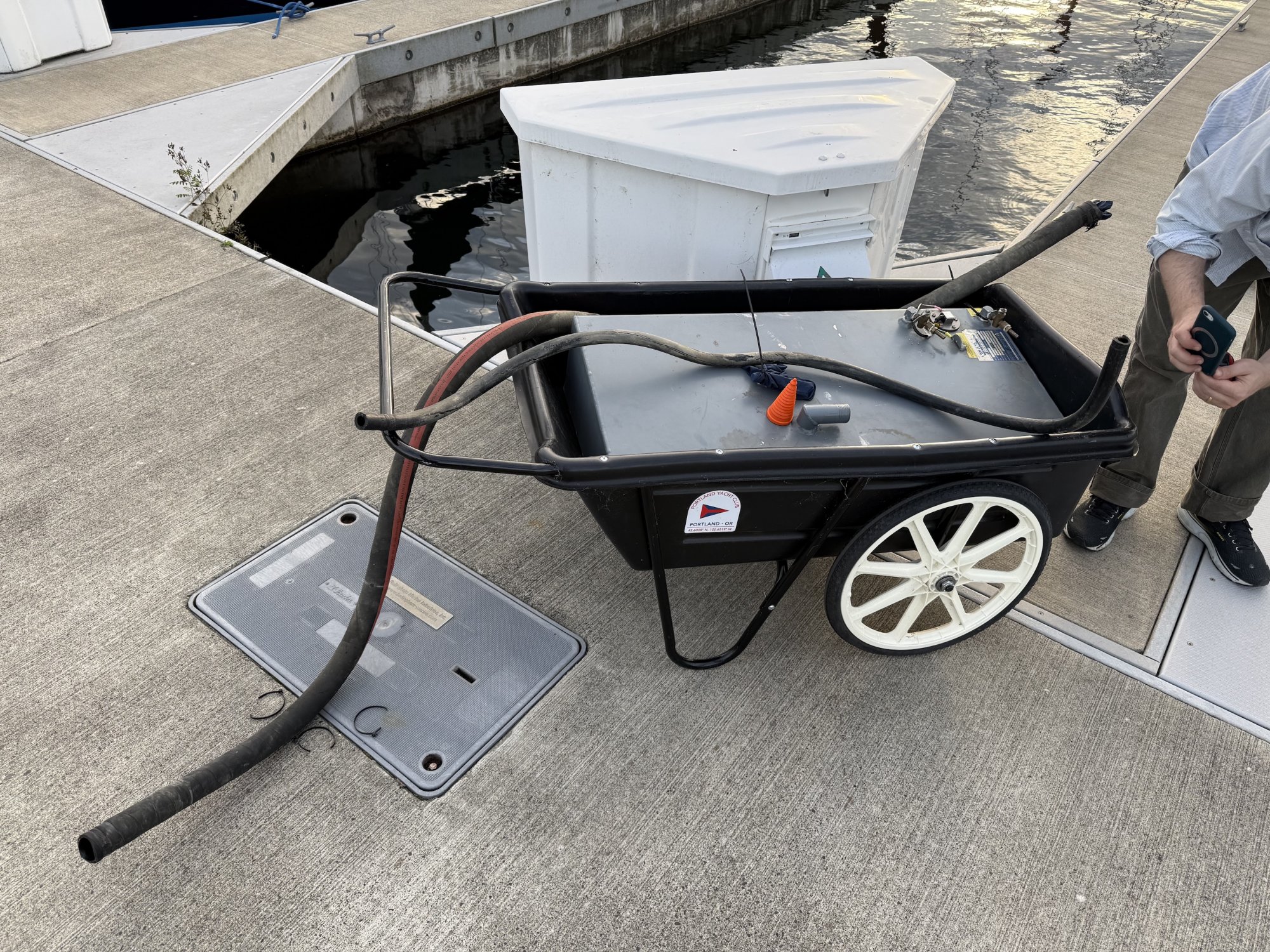

After turning the tank up on end, we carried it out and celebrated:

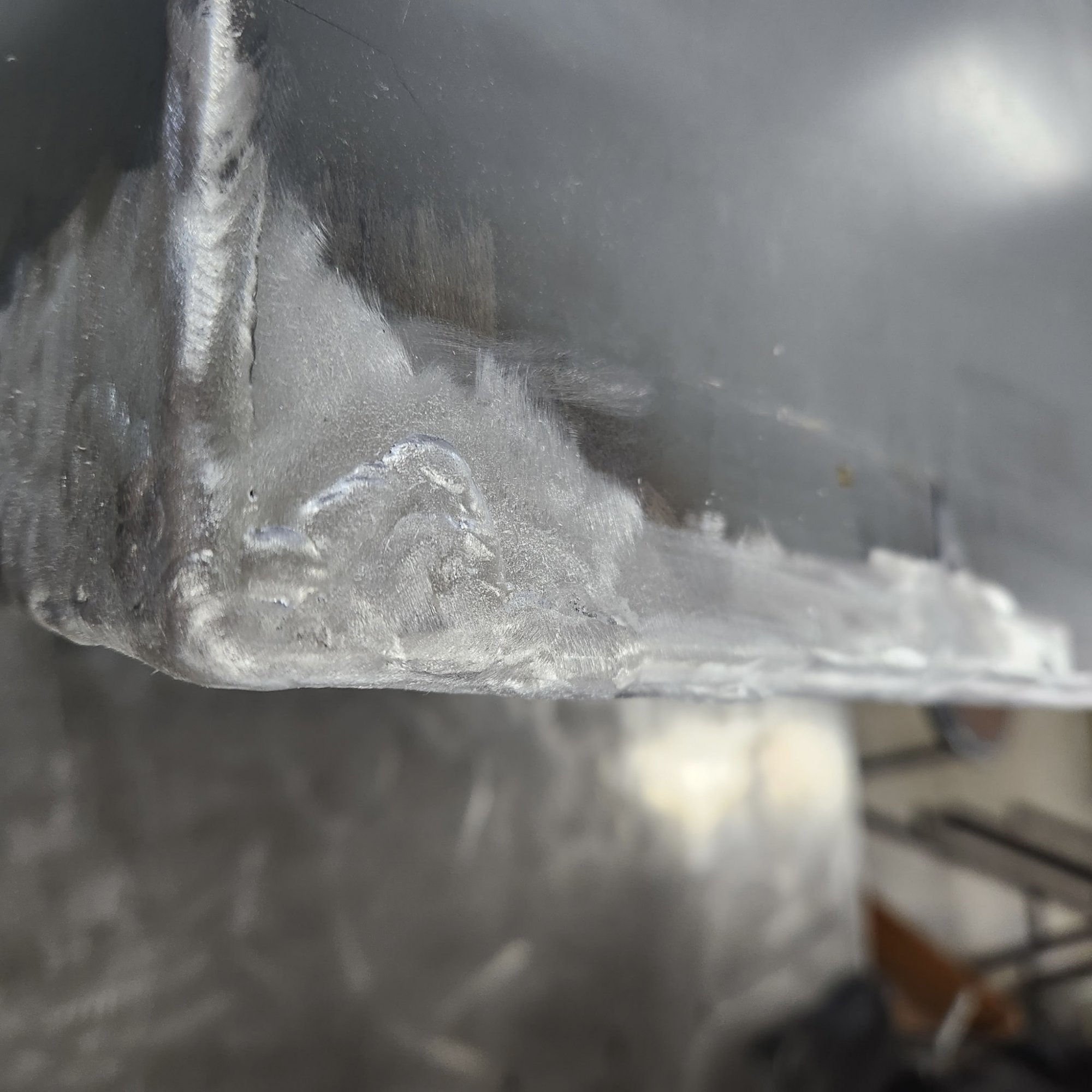

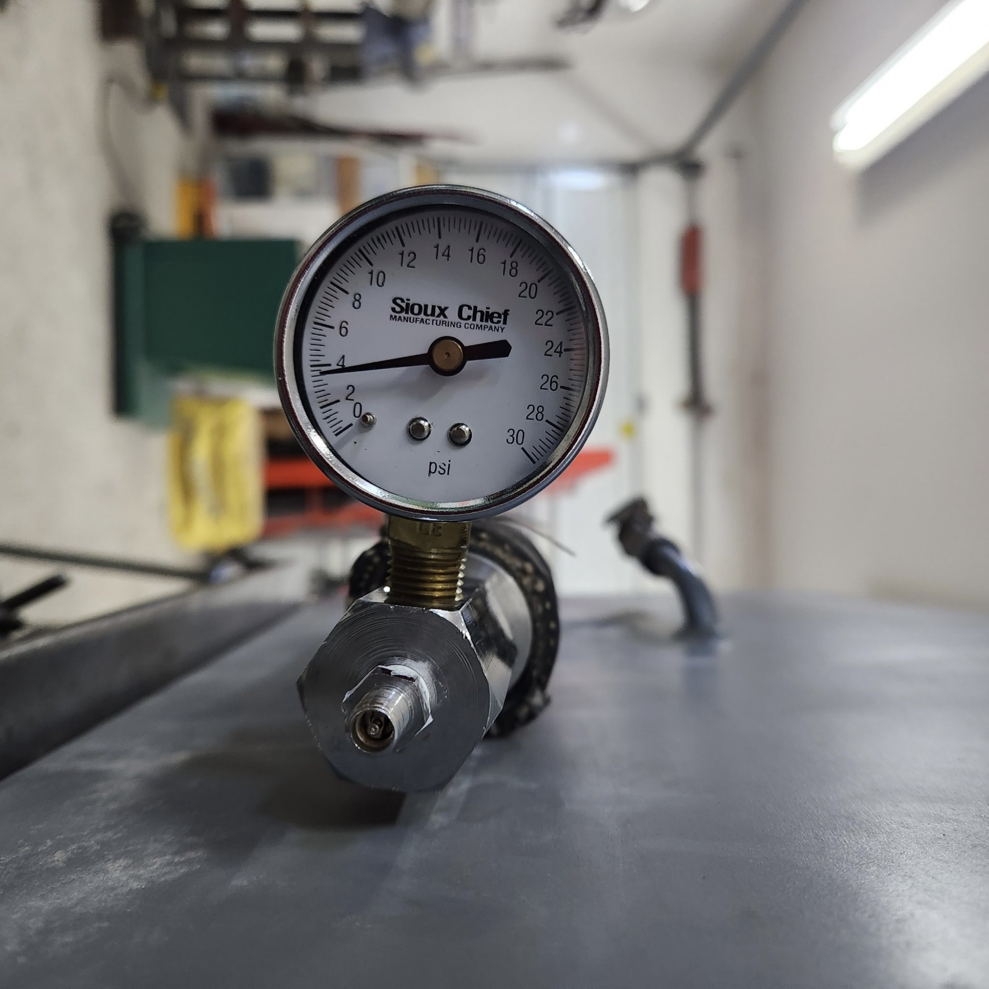

The fabricator patched up the tank, and then pressure tested to 3 PSI:
Per the fabricator's recommendation, I covered the repaired area was epoxy to waterproof the new welds. He also recommended painting, but I decided that it would be nice to visually inspect the welds in the future so I used 4 coats of clear West 105/205 epoxy.
I also installed 3x 2" wide by 1/4" thick rubber strips along the bottom of the tank, so that if a small amount of water got to that pan again the tank would sit above it. This will also make it far easier to see if the area is dry, and monitor for any leaks.

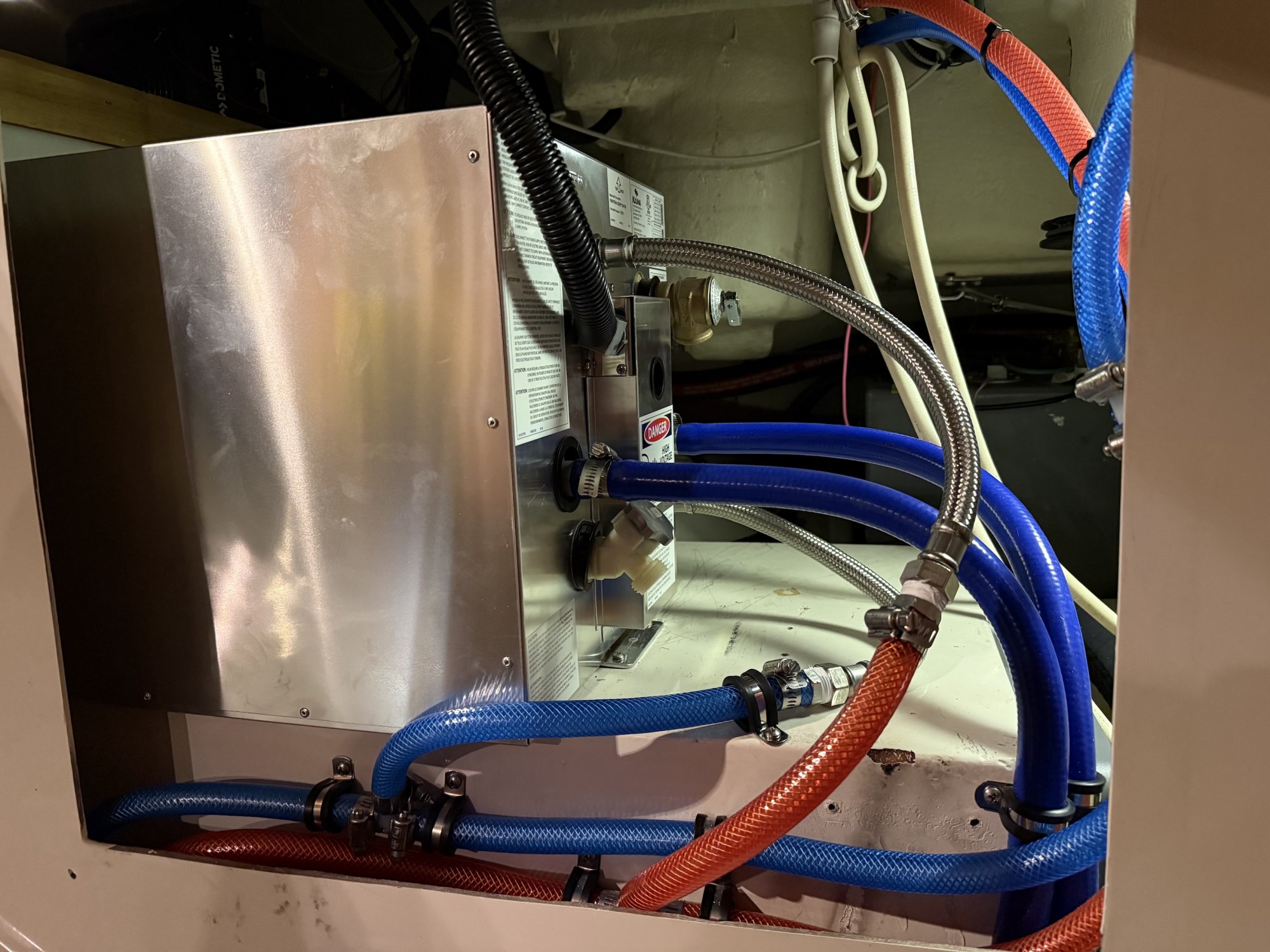

Here's the new water heater installed and plumbed:

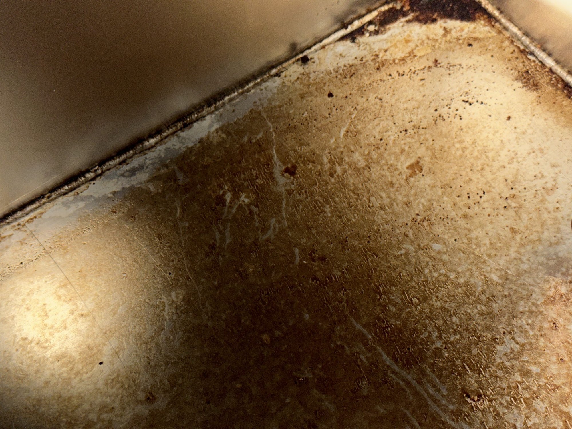

Update... I went to pull the tank today and these instructions were spot on. Took about 2 hours. The hole was on the bottom at about 0.25". Pics inside the tank show corrosion all over the bottom. No patching is going to work here. Replacements are soooo expensive!

There's part of me that wishes I just did replace it, but the machinist from the yacht club who welded in the patch was highly confident that the rest of the tank was sound. I'm not sure if the "factory tanks have thin material" comment that mainly seems to originate from Catalina Direct is universally true or just a rumor.
