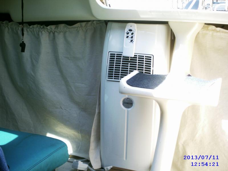

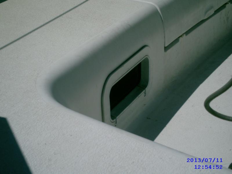

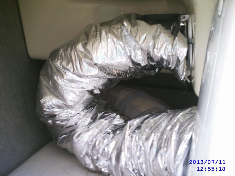

Re: How to remove the small plex fron a side port to install
on my 23.5 I have portable ac.Vent it thru port side portal in rear berth to cockpit.wrapped exhaust hose in insulation.Curtained off rear area as just use it for storage,only cools front of boat.unit sits next to stairs.5000 btu
