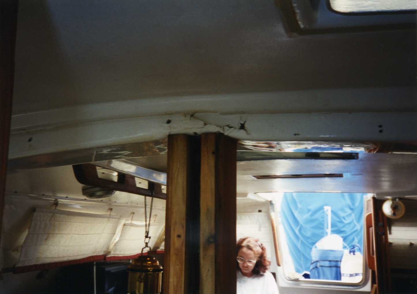

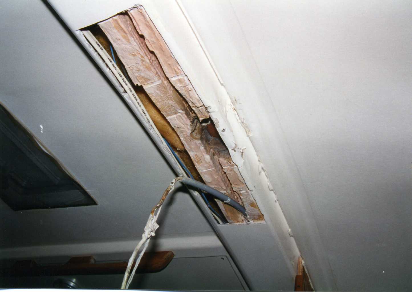

I'd be very suspicious of the hairline cracks around the mast step. My compression post was not rotted but the wood filler in the cross beam that it bears on was rotted, allowing the mast base to compress the cross beam causing spider cracks in the gel coat around the mast step.If you lay a straight edge on the beam where the compression post touches the beam underside, there should be no dimple caused by the post indenting the beam bottom. If there is dimpling deformation, the wood in the beam is gone and the step will have to have the support in the beam replaced .. Picture of the depression and of the beam cracks from the mast loads crushing it.. My post was not rotted..

As DJay and Kloudie1 say. The fasteners are under the mast, threaded and tapped into the aluminum plate. Luckily the deck core material under the aluminum is synthetic, not wood. But below that in the beam, was originally a piece of timber laid sideways. Mine had so much removed to allow passage of the wires, and it is off center from the mast to the post that it crushed. If you see a divit with a straight edge as kloudie1 describes, it's time to investigate further. BTW, I made my standpipe about 6" higher than the deck so I could create a loop with the wires before entering. That way water runs down the wires, past the pipe and not into it. I sealed it with silicone as the mast was being re-stepped.
