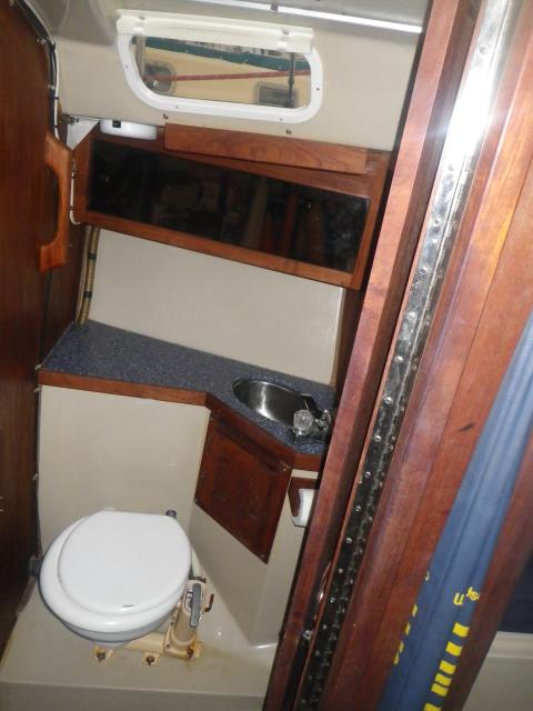

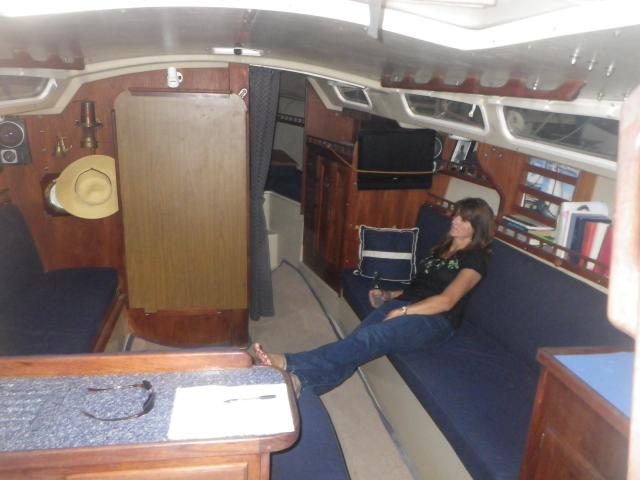

Corian tops!
I am a granite and Corian fabricator in Tampa and I templated beveled the outside edges and siliconed them right in over the existing tops. I laid it over the edge of the sink to give the appearence of an under mount sink then I made lids for each side to cover up sink for extra storage and to use the lids as cutting boards. I also made a square one to fit over the top of the burrners to give me more counter space. These pics were not intended to exhibit the tops they are just the only ones I have to give you a peak at what they look like. I can send more if I can find them?
