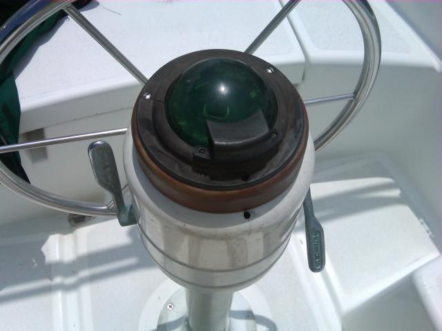

The OEM compass on my 1980 H27 is so clouded it is barely readable. I wanted to pull it and get it fixed or find a replacement, but I can't seem to figure out how to get it off the pedestal. The compass sits atop a wodden ring at the top of the pedestal. See pic below.
There are two remaining screws (third screw long gone) on the metal plate where the compass meets the wood ring. The screws come out just fine, but the compass does not budge. I tried applying a little pressure under the metal plate to see if I could ease it up, but the wooden ring began to crack - so I stopped that attempt.
Is it possible some marine sealant was used to adhere the compass to the wood ring? How is the wood ring secured to the pedestal?
I would like to get the compass off to not only replace it but to run some electronics wires inside the pedestal as well.
Any one have a suggestion as to how remove the compass without damaging the compass/ wood ring/ pedestal/ my hands???

Just the 3 screws
On my pedestal just the 3 screws need be removed and it comes right loose. A guess would be your's is glued down.

start by removing the 2 screws on top at 10 oclock and 2 oclock. this will allow the crome cover to be removed exposing the actuall compass mount which is probably 4 screws screwed into the pedistal itself.
Nothing to it. Replace mine last year from worst marine abt abt $500 bucks i think.

That is not a factory install. It looks like a previous owner just glued it to the wood base not thinking it may have to be removed at a later date. If the compass is as bad as you say you will need to replace it anyways as repairs would be too costly. I would pry it off even it it broke to reveal the screws holding the wood base down to the pedestal. Whatever you do not attempt to rebuild a compass by yourself. On these old compasses some casing parts may look ok but may be far from the tolerances needed for a good seal. Take it to a compass shop or factory service and let a proffesional work on it but like I said it would probably be more cost effective to replace.

Thanks everyone - My suspicion was that the compass was glued to the wood base, so maybe the base is screwed down to the pedestal. It seems as though one P.O. must have bought marine sealant by the gallon…
I will continue trying to pry the compass off the wood base and see what happens. I have no intention of opening the compass itself - at least not on purpose...
