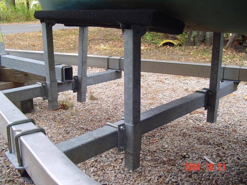

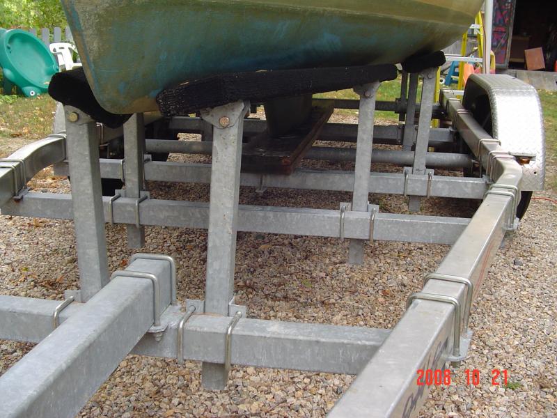

I recently altered a 20 foot EZ Loader roller trailer to accomadate my 1980 22 Oday. I replaced all of the roller brackets. I purchased 10 inch brackets from West Marine. I then used the old brackets to make a keel support.
I added a pic. I will try to get a close up of the keel support.

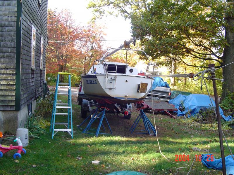

Your trailer is identical to the trailer that came with 86 O'Day 222 when I bought it new. My trailer had a rack with four 12" keel rollers.
Taking my boat off the trailer and putting it on boats stands was very easy with that trailer. It was even easier getting the trailer back under the boat by winching it under the hull without the towing vehicle. It took roughly 20 minutes. The trailer I have now is an all day affair for doing that chore.

I'm no expert. I altered the trailer, purchased the boat and winched her onto it. It was very easy, loaded on nicely. I purchased it less than 2 months ago. She is sitting for the winter.
Trinkka, I like that keel roller. I added a pic that better explains how I used the old brackets to make a keel support. I loosen the nuts shown in the pic, wench the boat up and re-tighten them.
