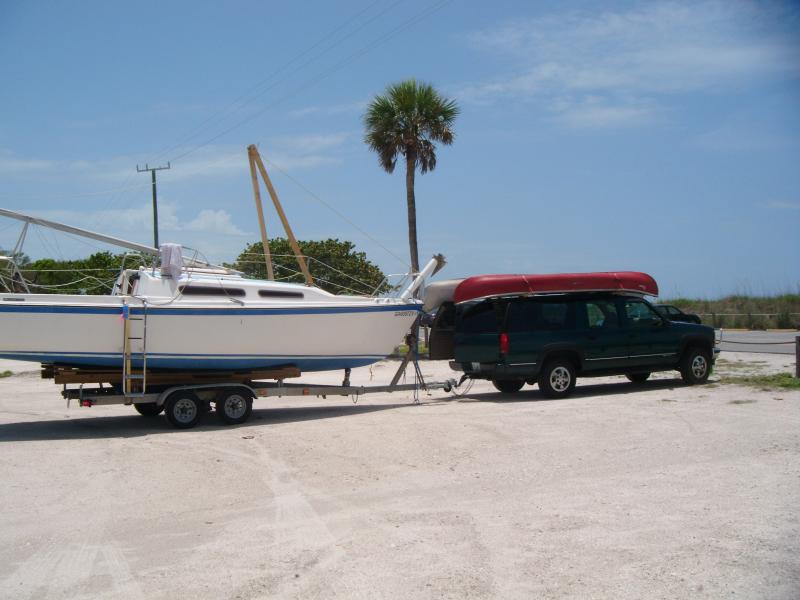

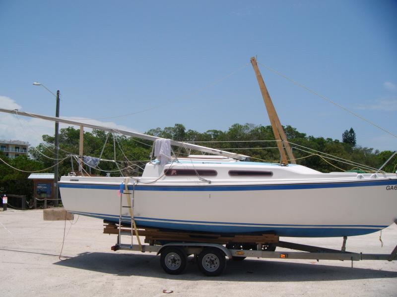

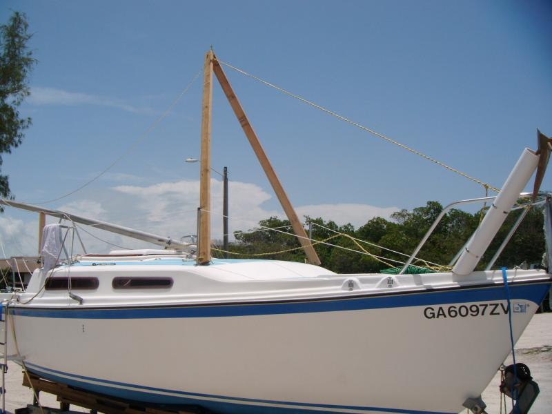

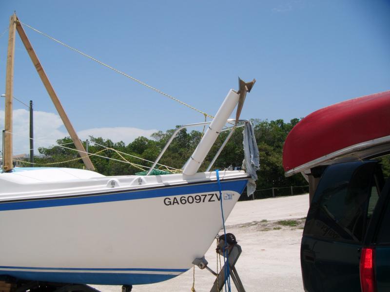

My mast raising system is two 2x4s 8 feet long with a bolt connecting them at the top. They are loosely attached to the life line stanchions. As the mast goes up the boards rise off the deck. I tie a line from the top of the boards to the front of the boat then attach the jib halyard to the same point through a pulley with cam cleats(From vang pulley system). I lock off the jib halyard and pull down on the jib halyard underneath the triangle formed by the boards. I usually do it on the water. I have had boats go by with large wakes as I am raising the mast and it is held on track to the top by the system. As the mast goes up it gets more stable due to the shrouds starting to keep the mast on track.
Wrote too much already. A picture is worth a thousand words. See below for a few thousand words.

My mast raising system is two 2x4s 8 feet long with a bolt connecting them at the top. They are loosely attached to the life line stanchions. As the mast goes up the boards rise off the deck. I tie a line from the top of the boards to the front of the boat then attach the jib halyard to the same point through a pulley with cam cleats(From vang pulley system). I lock off the jib halyard and pull down on the jib halyard underneath the triangle formed by the boards. I usually do it on the water. I have had boats go by with large wakes as I am raising the mast and it is held on track to the top by the system. As the mast goes up it gets more stable due to the shrouds starting to keep the mast on track. Wrote too much already. A picture is worth a thousand words. See below for a few thousand words.
Patrick, thanks for responding to my post.
Do you pull down on the line with your hands to raise the mast?
How do you prevent the mast from falling to the side as it is being raised?

When you pull down on the line the pull is coming from the top of the boards. If the mast starts going sideways it is pulled back to the center because of where the pull is coming from. I have done this many times. One time it went to the side for some unknown reason. The shrouds did not catch on anything and I was on the trailer so no waves threw it off. I just kept pulling up and as it got higher it came back to the center and the shrouds took over.
The best thing about this system is that it cost less than $10. Also no baby stays.
The bad thing about this is that to carry it on board to get under a low bridge I have to store the 2x4s on board.

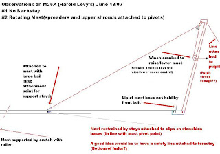

On another thread, dscribner beautifully draws what I have described.
http://forums.macgregor.sailboatowners.com/showthread.php?p=1127297#post1127297
Thanks, dscribner!
