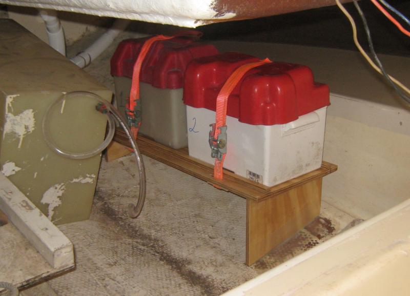

The PO of my 25 did a similar thing: a non-levelled battery platform under the port settee. However, he hadn't even glassed it to the hull. It was free to slide around.
Pressure buildup during charging forces the liquid out the vent holes, lowering fluid level and damaging the battery.
I built a proper hold-down platform and glassed it in, level, under the cockpit. Getting it level was a real trick, but is essential.
I took this picture from the cabin, when the aft bulkhead under the companionway was removed.

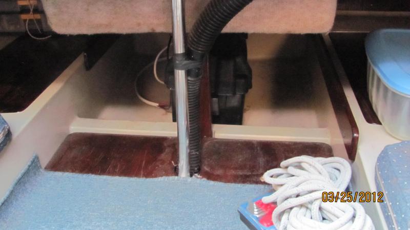

I have an 86 O'Day 222 that I bought new and the battery is supposed to be placed in a battery box in the cabin under the cockpit in the center of the sole. If you have the battery box, all you really need is the battery hold down kit. http://www.nextag.com/marine-battery-box/products-html
Click on this link. It looks like the next to the last one on that page.

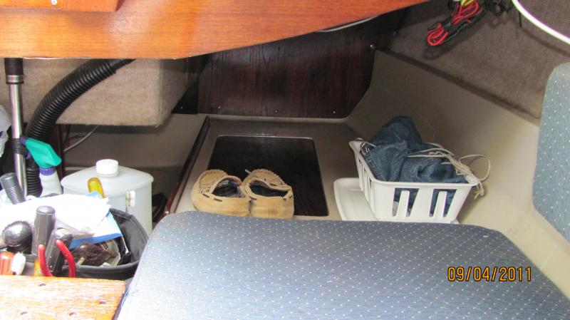

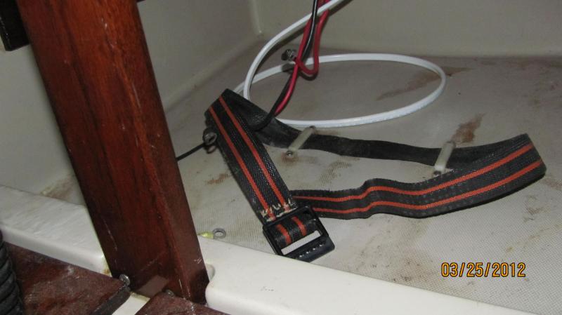

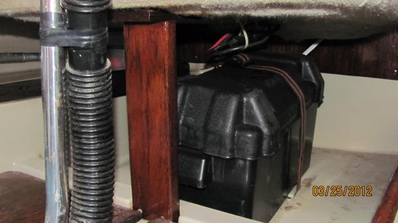

I just put my battery in my boat. Here's some pics of it.
Joe

Trinkka's installation is the more elegant solution.
I didn't appreciate how different the under-cockpit area is on the 222 vis-a-vis the 25.

I think that if he checks the sole under the cockpit he's going to find the four screw holes where the plastic strap brackets were originally installed Joe.

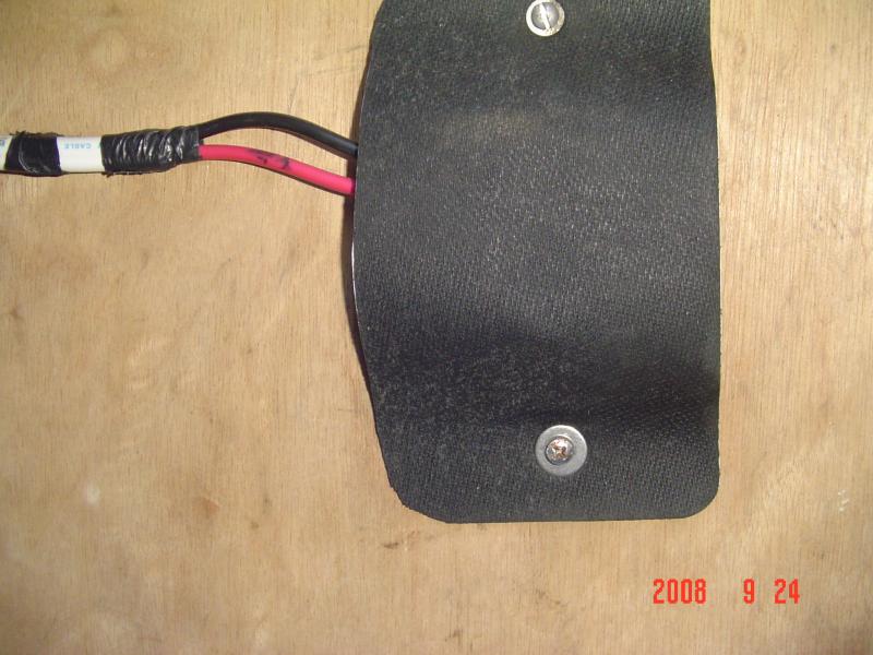

Several years ago I mounted a four terminal block on the rear bulkhead in the Port lazarett under the hatch, and ran a #10 copper stranded duplex cable from the block to the battery. I replaced the outboard charging duplex with a #10 duplex and I have it going over the transom and through an outlet hole to the other side of the terminal block.
I covered the connections to this block with a PC mouse pad attached with wood screws. All my connections have crimp ons with eyes. I have nice solid connections with plenty of juice going to the battery from the outboard's charging system.
I've found this to be better than marine outlets with plugs.

Joe of Trinkka, I looked in the area under the cockpit where you have your battery mounted, and I couldn't find a single hole for a hold down strap or anything else there. The #10 wires from the circuit breaker box were ran aft into the port lazarette and to the area I described in my original posting. As I mentioned, there is a wooden tray in the bottom of the lazarette, with rails all around to keep the battery box from sliding around, and it is solidly glassed to the hull, but at the same slope as the hull. I don't know if this was "factory" but it sure was put there for the battery. I didn't find time to get the boat in the water last summer, so I never installed a battery, but I have the plastic battery box, and I also put in a terminal block where you did. Actually, the terminal block is a master circuit breaker, so the battery #10 wiring goes from the battery up to this circuit breaker, then from there #10 wire to the circuit breaker panel in the cabin. I have been kicking around ideas to build a level platform over this original sloping platform, with rails all around, glassed in place, and with new battery box tie-downs. Actually, the area under the cockpit where you have your battery is ideal for storage to my way of thinking, and I'm thinking of putting in a rectangular, gasketed, after-market floor hatch in the cockpit floor so I can access this area easier. I've seen several fiberglass?plastic? floor hatches listed in several catalogs, apparently strong enough to walk on, and some are even lockable. I thougt I could store groceries or other stuff down there, and get at it easily, and altho minor, the weight of the stuff would be centered low and over the keel line. And, while it obviouslly must not be a problem, I just wasn't too excited about having battery fumes released into the cabin area, however minor, if the battery was within the cabin and somehow not vented. I'm planning a lot of over-niters, and I felt there COULD be health issues, explosive gasses issues, and corrosion issues. I know there are many, many boats with the battery in the cabin area (my previous Columbia 22' for example), but since I have a choice, why not keep the battery out of the cabin ?? Anyway, as soon as I get the battery located and properly secured, and charging wiring ran from the Honda OB generator to the battery, I'll be ready to finally get her into the water. I can hardly wait. Thank you both again for your inputs, and I'm starting to sketch a sturdy wooden, painted, level platform. All you guys, and this forum, are great !!!!
Richard Brees

I have a sealed 100 AH deep cycle battery and there is no cause that I can see to be concerned about fumes. I've had the filler cap type batteries on my boat in the past.
I have no idea why they put the battery in the lazerett on your boat. O'Day was always experimenting with these boats and adding different features. Maybe your boat came through that way. Myself, I like the battery where it is on my boat because it's out of the way.

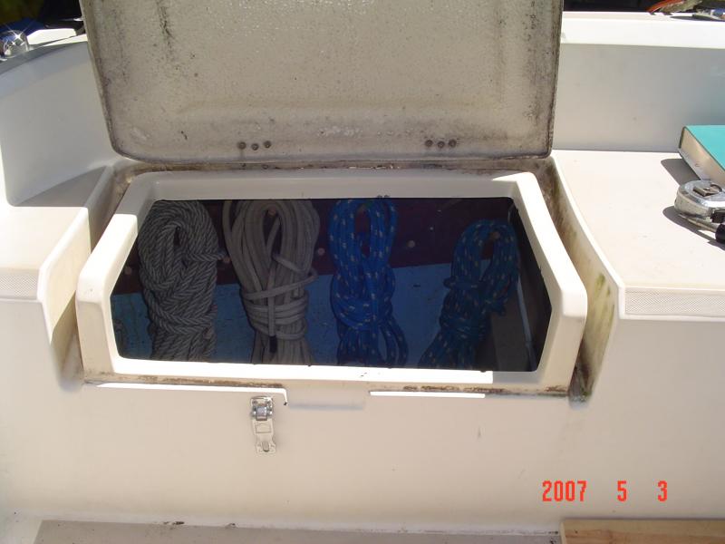

I store all my lines in the lazarett along with two buckets, one of them a five gallon plasterer's bucket, an anchor with 150' of 3/8" line, three poly tarps, four fenders, a four gallon sun shower, and a one gallon weed sprayer for it's cooling mist spray on hot days, and rinsing dishes.
I just found out yesterday that the sphereical radar reflector that I've been storing on my boat for over twenty years now isn't any more effective that a Burgee with metal threads. That thing is coming off my boat today. I'm cutting down on junk that I don't need on that boat.

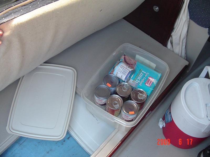

As far as food storage goes, I have about six Rubber Maid rectangular 2.2 gallon containers w/ lids that I keep under the quarter births for can goods and food storage. I plan on buying my food this week and loading them up. They will stay on the boat all season.

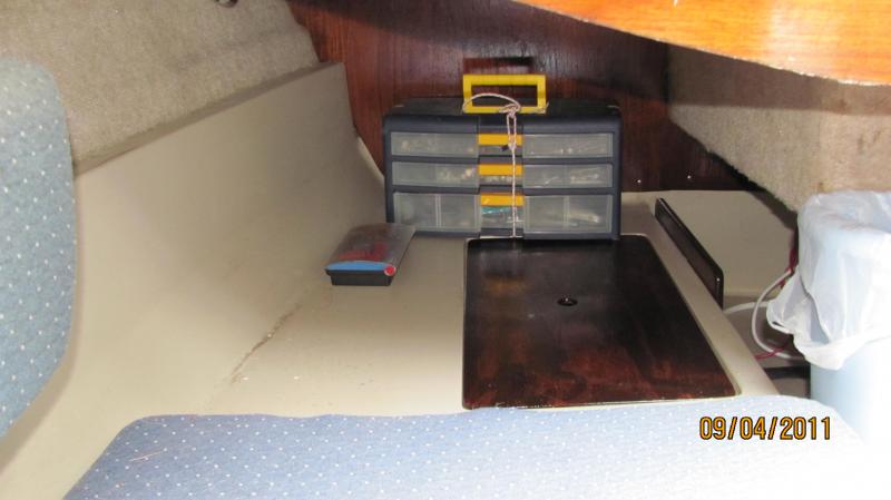

This year I'm going to eliminate the two quarter birth mattress that fit under the cockpit seats. This area will be used for gear storage. There will still be enough room for cabin seating or sprawling out on the quarter births, but it will also allow me more access to the compartments in those two cubby holes in there. I'll also be able to store my extra cooler in there.
There's still enough room on the sole plate where my battery is located for my stove fuel and anything else that I need to put in there.

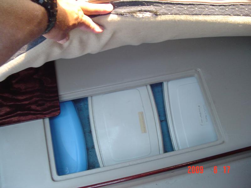

Thanks bear. Necessity was the mother of that idea. I hated having to remove the Starboard mattresses to get my 48 quart cooler to slide in behind that step. With that removable step, I can lift my 50 quart cooler over those two step mounts and get it in and out of there with no problem.

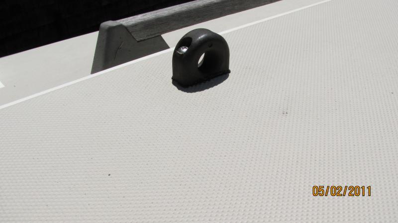

Last year I installed two plastic fair leads on my sliding hatch cover to secure my Stern's Sunshower. I had been securing it to my mast which was a pain to access each time I wanted to take a shower or rinse off a large sudsy pan. Now, all I have to do is bring the hatch back toward me and reach for it from the cockpit, and I don't even need to untie it to rinse off a pan. I just hope I don't lose what I'm rinsing, over the side. I'm good for that. :)

All four O’day 222s I have seen (1985, 1986 (2), and 1987, representing both MA and CA manufacturing facilities) had factory battery location in the Port lazarette- accessed from cockpit. The Oday 222 sales brochures support this location as the original battery placement. You make a good point to keep battery level- I recall all I have seen had battery platforms that aligned with the sloping hull (i.e. battery platform not level). It would be an easy fix to correct the sloped storage pad and leave battery in original location.( I will be adding this to my list of things to do).
P.S. I am not near my boat now, but wherever you mount make sure you have an inline fuse between battery and breaker panel. I recall the inline fuse from the battery to the breaker panel is 30A.

Thanks Mich 222 for the information. I'm going to wire brush the finish from the inside of the hull at the new contact points and install a level battery rack over the top of the original battery rack similar to Joe vanDenenden, fiberglassing the new support to the inside of the hull. Leveling will be easy while the boat is on the trailer. Yes, I went to an auto parts store and bought a 30A resettable circuit breaker with mounting flanges and mounted it on the plywood bulkhead (lazarette side) near the battery location. Then I ran #10 (I think it is heavier) wire from the positive battery post area (don't have my battery yet) to the circuit breaker, then a #10 or heavier wire from the circuit breaker to the breaker panel inside of the cabin. Reason I'm not sure about the wire is that I'm using the wiring that was already in the boat. There was an excessive length of black and red wire in the lazerette area, so I was able to to cut to the lengths I needed, and still had wire left over. I soldered the wire ends to copper terminals for attachment to threaded posts, so I will have good connections. I've sailed in some heavy weather in the Pacific, so I'm going to make a wooden rack with plenty of strength and bracing, and besides the two attachment points at the hull, I'm going to also attach it to the fiberglass bulkhead that separates the lazarette from the cabin adjacent to the battery. I'll hopefully never be in the kind of weather I sailed in off the Santa Barbara coast, ( I took heavy weather training there and lived there for a few years), but I don't want that battery breaking loose !!
Mitch,
I've only seen two 1986 O'Day 222s up close, mine and my friend David's which he bought from my friend Walter years ago. I'm pretty sure that David's boat is set up similar to mine with the battery on the sole plate in the cabin. In fact I had emailed him about this and he replied that his boat is set up exactly like mine as far as the battery placement behind the step in the cabin, under the cockpit is concerned.
I don't doubt that one or two of the O'Day factories built their 222s with a provision for the battery in the lazarette. They were always experimenting on these boats trying to find ways to cut costs.
When you think about it, it's a heck of a lot cheaper to relocate the battery storage area to an existing spot in the cabin where they only needed a battery strap and plastic brackets than it was to glass in a special mount for the battery inside the Port lazerette. It's possible that when they mounted the battery in the Port lazarette, they figured it would offset the weight of an 8 hp outboard motor on the Starboard side of the boat's stern. The best trade off I can see is more room in my boat's lazarette and I still have plenty of room to store gear next to my battery box on the sole plate.

Mitch I have the 1984 222 and originally my battery was in the lazarette. I moved into the cabin simar to where Trinka's is. I Built a platform which was no issue to help balance the boat.
