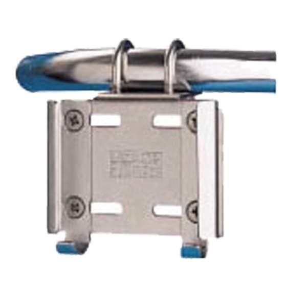

My neighbor has the other style of rail mount Danforth hanger, and he likes it as well.

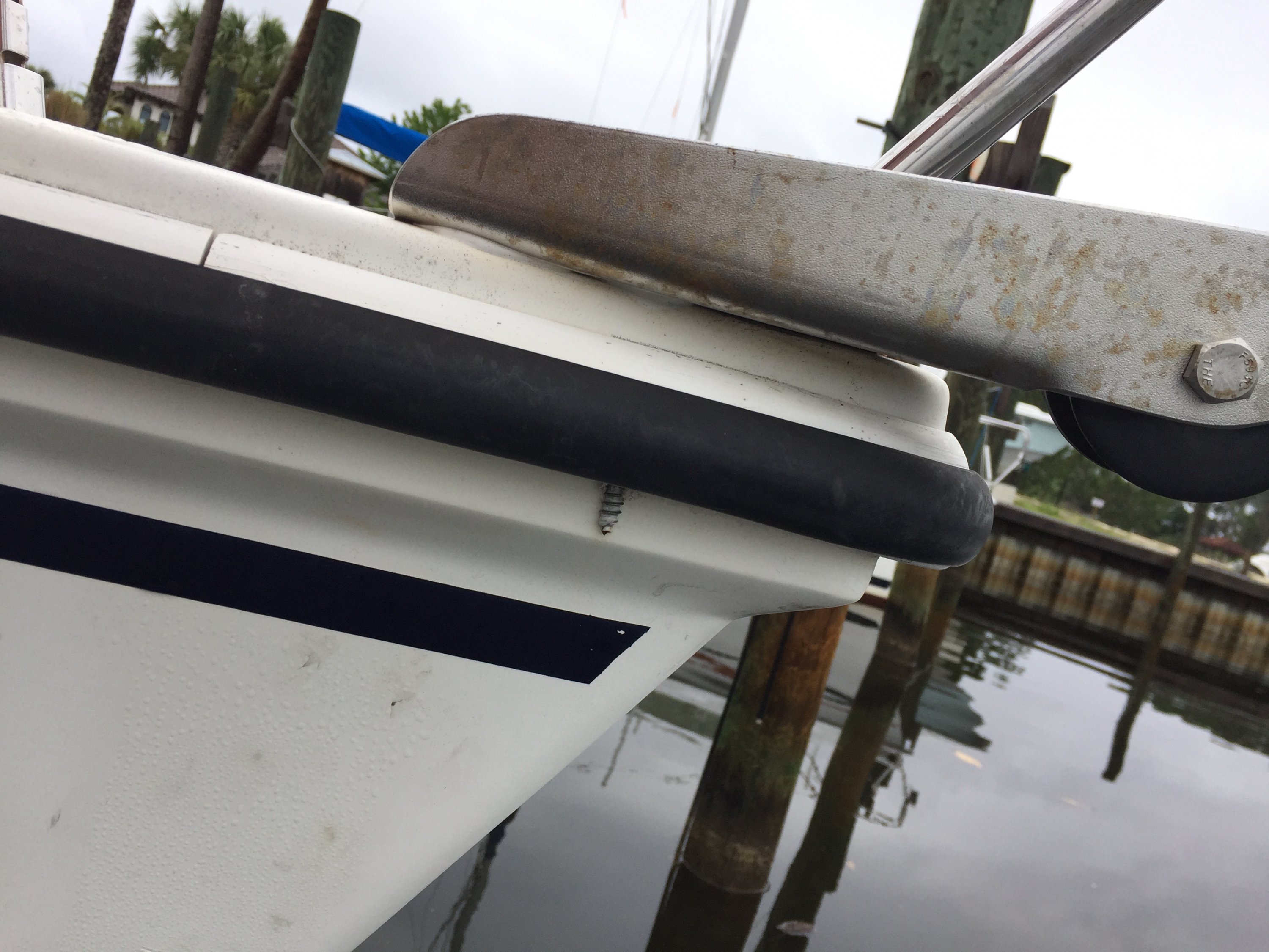

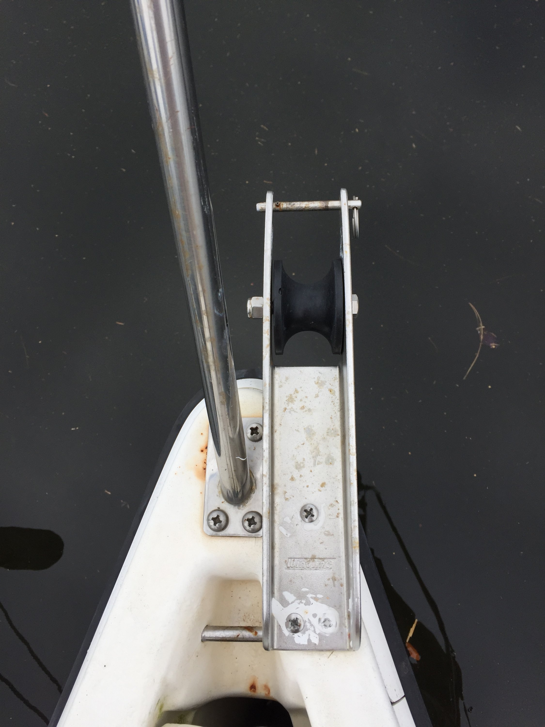

I installed a roller on my H23, however I do not have pics. (I can grab some tomorrow) Things I would have done differently you can tell in the pics. Also, I use a delta on it only as I approach an anchor site, never while under way.

Sorry for the delay, but here is what tried for a bow roller on my H23. My next project will be servicing the rub rail so I'll have a better idea on what reinforcing and repairs I'll need to do. Kind of embarrassed to show but learn from my screw-up (pun intended). Fortunately it works fine and does not flex or move when weight it applied. You can see the one screw and they are all that length (3 in total). No issues with the pin either being in the way.
Again, I don't use it for a danforth, but a delta.
