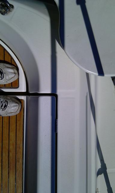

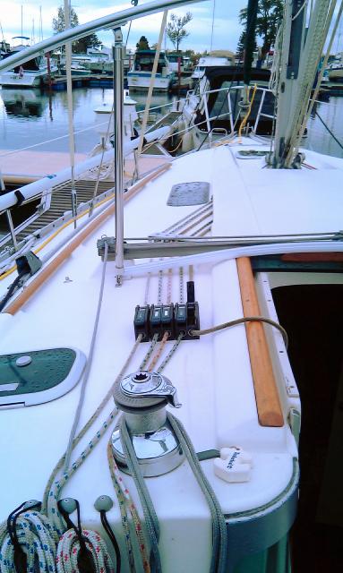

Included some not so great pics of cetol natural on my 352.
Enjoy:D
