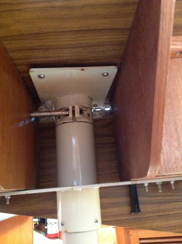

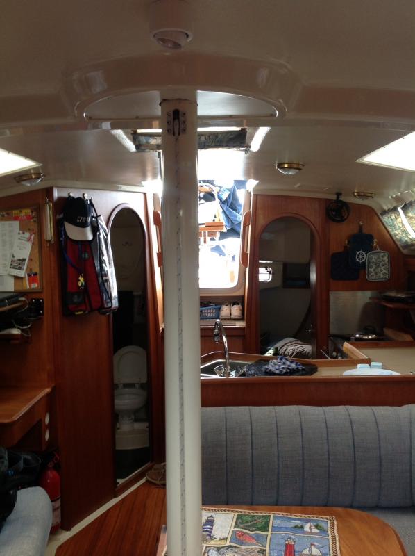

I have a 1990 Hunter Legend 35.5 and can't for the life of me figure out how to lower the cabin table in order to use it for a bed.
It has a rope attached to the compression post and I'm afraid to undo the knot under the table. I can see it routes through a pulley mechanism, but it will only lower to a certain point. If I undo the knot, I'm afraid I'll lose the rope routing and end up eating my meals at floor level :cry:
I'm including some photos to show the lay-out and would appreciate any insight.

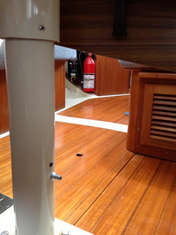

If you have not looked in the little compartment in the table top that is forward of the mast, look in there and you will see a t-handle which must be loosened before dropping the table. Something odd in the last picture is that there is stud of some sorts sticking out of the compression post which could prevent the table from dropping all the way down. Does the table move at all?

It only moves around the post, not up or down. I did loosen the T-handle all the way but it makes no difference. Maybe I just have to be a bit more forceful.

Those little screws at the base of the sleeve also press in against the post. All of this is likely to no avail however as with our vintage boats, years of leakage from the mast down into the column plus salt air have likely rusted and fused the counterweight that's inside the column to the column inner wall.

I missed seeing the screws in the sleeve. They, most likely, are what's preventing the table from moving. Also, even if the counterweight is froze inside the column, the table should move up. If you pull on the rope, the counterweight should move. If not, the table should move up and down with the rope untied.

With leakage around the exterior of the compression post, the table may be frozen to the post. The interior of the sleeve around the compression post has a rubber gasket in it and after years of having the table locked in one position for dining only the gasket hardens and locks to the post. The only way I found to found to free it was to remove the table from the mount and then slowly work it free by moving it round and round the post and up and down little by little until it freed up. The bolt through the post belowthe table will not prevent the table from reaching the bed position on the sette but it will stop the counter weight from moving past that point.
