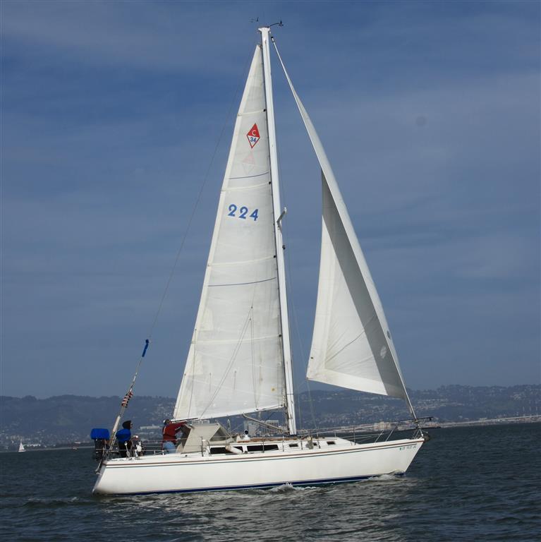

23,131
Stu: For sure I thought you would have the Garhauer adjustable system.
Don,
I raced back in SF without it. Moving my car back with the two jibs I had (but I did use my "BIG" 110 for racing!!!) would only serve to open the top up, not helpful. So I never did get the car system, although I know all about it and have friends with C34s with them. I also don't have an outside track. My PO did some nice things (Harken batt car system, rigid vang, adjustable whisker pole ring) but left a lot of other "sail oriented stuff" out of the package. I ain't complanin', though. :)
My ProFurl raises the tack high, too, deliberately.
