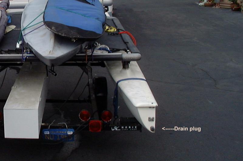

I was going to install a drain at the lowest point of the transom on the Mac 25. The Hobie 16 that I had, had one through the transom. I was a plastic (pvc) threaded plug. The idea is to drain the boat while it is on the ramp. While on the ramp the lowest point is the transom on the Hobie and Mac 25 anyway.
I also had an inspection port on the Mac 25 at the lowest point of the boat. The inspection port was to service the transducer for the depth gauge. I kept a pool slurp gun on board to suck out the half gallon of water that would sometimes collect there. I learned that from my kayaking days.
