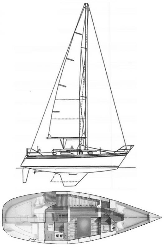

I have a 1977 Hunter 30 and was told the draft is 4'9". from everything I read the draft is either 5 1/4 feet or 4 feet. how do I tell which model I have - other than pulling the boat out of the water and measuring. is there a specific hull number identification?

In the drawing attached below they show the shape of the full keel, and the shoal draft keel (shown with a dotted line). Take a look at yours, and you will be able to figure out which one you have..

Thank you. From the keel shape, as I recall...definitely shoal draft...
