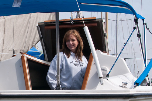

Installed two hatch struts (trunk lid shocks) onto two pieces of L shaped aluminum to replace the two wood pieces below the window and give enough room for the shocks to rest inside the track. I need to take a better photo of the mod, but here's the shocks in the up position. They are weighted enough to hold the hatch up and then you just push it down to close, like a car trunk.
Click to view it bigger.

Thanks, all. I will eventually do something like what Paladin did. Where did you get those struts? In the meantime, I like the shock cord idea.

Brilliant idea!
I was thinking about adapting some hatch adjusters, but your struts look great!
Crew don't look too bad either ;)

Thanks! :) I highly recommend the strut mod, pretty easy to do, and it makes the hatch SO easy to manage! Emily loves it too... as you can see! LOL

Looking forward to some close up photos of the hardware and what size struts you used. Mods like this make the H23 that much better.
