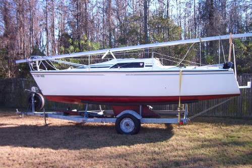

Here's a method I developed for getting my H23 on the trailer with no help and no fuss and you WON'T get your feet wet either. Please try it and tell me what you think.a) PREPARATIONWhile the boat is still properly positioned on the trailer, mark a spot on each side of the trailer frame right below the main winch. Get a couple of pieces of OLD double-braid dockline or sheet (3/8 or 7/16 works best). Each piece of line must be long enough to tie to the frame using a round turn and two half-hitches (very important - the knot must not slip) then go up, take TWO turns around the winch and go through the jibsheet cleat with plenty of tail left for a good grip. Mark each line clearly where it leaves the trailer frame and where it leaves the winch. Clearly mark each line "port" and "starboard" because the length of the run around the winches to the cleat is not the same on both sides. Remove the lines and stow them somewhere securely. Put the boat in the water and go have fun.b) RETRIEVING THE BOATi) pull in and tie up to the dock behind where the trailer will be when immersed.ii) take two fenders or other floats to the tow vehicle. Re-tie the two lines to the trailer as before, making sure you have the port and starboard sides correct and that the lower mark on the each line is right at the trailer frame. Tie a fender to each line. If you put a loop in you can retrieve them with a boathook, otherwise you can lay on the deck and reach overboard. Lay the fenders on the trailer where they will float clear outside the trailer bunks when you back into the water. The lines must not come up inside the bunks. Lay any excess line on the bunks so they are won't be fouled by the trailer wheels.iii) back the trailer into the water a bit deeper than you needed to put the boat in. This is not a critical measurement, but it works best when the trailer is just a little bit deeper than you need to float the boat (there will be less slack in the line as you pull the boat out and less chance that the boat will move around).iv) set the parking brake, turn off the engine and chock the rear wheel on the driver's side. A piece of light line tied to the chock will allow you to retrieve it from the driver's seat when you are ready to pull the boat out.v) use the docklines and pull the boat forward until the bow is in the chock on the trailer. Retie the docklines to keep it there. Running the bow line around the front post of the trailer helps. The stern may drift a bit but don't worry.vi) go aboard and retrieve the float and line on each side. Bring them aboard, take two turns around each winch and go through the jibsheet cleat. Pull in by hand, starting on the windward side of the boat. Use the winch handle to help you "sheet in" each line equally (watch the reference marks). As you "sheet in" the stern of the boat will be pulled down onto the bunks. The worn double-braid offers excellent grip when wet.vii) go to the bow and check the bow mooring eye. You can adjust the trailer winch as needed from the bow without having to get into the water.viii) get on the dock and undo the docklines. The boat should remain securely in placeix) haul the boat out. As the tow vehicle moves forward, hold the line for the wheel chock so it comes out behind your tow vehicle and doesn't obstruct the trailer wheel.x) the boat should be properly centered on the trailer. If it's not quite right, replace the the double-braid lines with your trailer tie-downs. Tighten the one on the high side and leave the low side slack. Back the trailer into the water until the boat just floats free, then pull out again. The boat should now be centered, but if it isn't repeat the process (adjusting the tiedown tensions) until it is. The boat may also be a few inches back from where it should be. Slide it forward into the bow chock using your favorite method, then add the bow tiedown.I also used this method once when the trailer wheels had fallen off the end of a ramp (thanks to power boaters "power-loading" their boats). The buoyancy of the boat lifted the trailer off the bottom so the wheels came over the lip of the ramp. Good luck and happy H23 trailering!PeterH23 "Raven"
