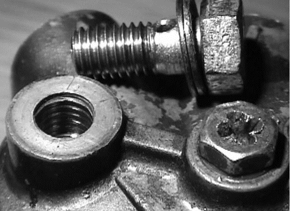

Greetings. Suppose that in the course of bleeding the engine (2QM15) after replacing the fuel tank on a '79 H-33, one stripped the theads in the fuel filter housing (see attached photo) so the bolt will NOT screw all the way down. Before going to the boatyard, I thought I would ask the very knowledgeable and helpful folks on this list if they had any advice on what I need to do to get this fixed.

The easiest method is to use a thread cutter ot the next larger size thread, and replace the bolt with the appropriate one with a good washer., and this time, do not overtighten the bolt!

Use a tap of the same sike to clean the threads. THEN seal the bolt with locktite and never bleed with that one again. Instead use the larger bolt or the outbound fuel line.

I taped it with a 1/8-pipe tap; put in brass male to female adaptor and a brass plug in the female adaptor. Now when I bleed the fuel system I don’t touch the aluminum filter housing I just take out the plug, screw in a 90 degree, 1/8 pipe to 1/8 hose barb put a length of clear tubing on and crank away.

Some good, some not so good. First, no insurance guy could say a thing about your boat based on information gleaned from posts here. Second, diesel fuel is difficult to light off. Best done under either compression or atomization, which thankfuly happens INSIDE the combustion chamber. Dispite the Hollywood excitement, diesel is even harder to light off sitting on water, as it usualy is in a boat. There are lots ov boats out there with a load of diesel floating in the bilge, for better or worse and they rarely light up. Third. The fittings on these engines are assuredly not "bastard". They are world standard. Alass, it is the US who continues to produce bastard fittings by insisting on continuing to use the long outdated fractional inch system. Even the ENGLISH gave that up years ago! The thread that was buggered was probably at the very top of the hole. It most likely could have been cleaned up from below in a very simple procedure we could have talked you through. At $42 the fitting isn't all that costly, although it could put you about half way to a new halyard. The brass banjo washers, in my experience can be re-used several times if you're just cracking them slightly. They can be refreshed over and over (if you're really cheap like me) by annealing, which is heating to cherry red with a torch and allowing to cool without quenching. To seal the bleeder better than the brass washer on the filter housing Yanmar has plastic washers. Just buy the part for the later models. I believe the part is a "common part" with the second portion of the number indicating the size. Don't be in the least bit surprised if your Yanmar parts guy does not know this. Just get the plastic washer with 06000 or 08000 in the number corresponding with the size used on the QM. I can't remember the size offhand. Too much other "valuabe" information crammed into my head, you know.

Using a helicoil worked
Thanks again for all the advice. My original solution was to simply order a new assembly. Although it was supposed to arrive in two days, it actually was not going to arrive for two weeks. Since I did not want to wait two weeks, the parts supplier suggested I buy a helicoil kit (8 mm X 1.25 mm). I had no idea what that was. This was an elegant and far less expensive solution. I won't go into how hard it was for me to find it, but the kit cost $23.00. It includes several coils, a tap for rethreading the hole, and a tap tool. It did not include the drill bit needed to drill out the old threads (I left that info on my boat, so I can supply it later). Basically, you drill the old hole, use the tap to make the new threads, then use the tool to screw in the coil, which now becomes the new (much stronger) threads. The original bolt worked perfectly. After purchasing some new (plastic) washers, I reinstalled the assembly yesterday. It works perfectly.
