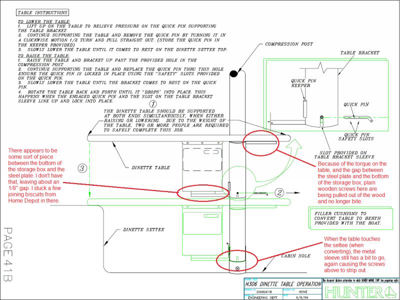

My recently acquired H306 has a lovely dinette table in the cabin - I'm sure you're familiar with it. Closer examination showed that it is mounted to a steel plate, which is in turn welded to the top of a steel sleeve around the compression post. A second steel plate welded to the bottom of said sleeve supports a storage box. Presumably, this storage box is supposed to add additional support to the table, because otherwise I would imagine the torque exerted by the weight of the table on the screws would be overwhelming.
The attached is a diagram to illustrate my problem.
The problems I see and need to fix are as follows:
1) There is about an 1/8" gap between the bottom steel plate and the bottom of the box causing the screws between the table and top steel plate to separate.
2) When converting to a bed, the table sits on the settee before the metal sleeve is all the way to the bottom of the post, again causing torque and screw stripping/table separation.
In an attempt to fix this at least temporarily, I inserted a few joining biscuits (1/8"-thick pieces of wood or something available at Home Depot) between the box bottom and the bottom steel plate. Seems to have helped a tiny bit, but does nothing about #2 above.
I'm just curious if anyone has run into this on their boats. I would imagine it's not specific to the 306. Since the screws will no longer really grip the table I think I'll need to drill all the way through and use nuts and bolts. Not as pretty, but should at least hold the bloody table to the steel plate.

I think your problem may have been caused by that gap between the bottom of the box and the lower plate. It may have been that the plate was not propely positioned during welding or the gap was not properly filled in the assembly process. Now you have damaged screw holes in the bottom of the table top. I gather the table top and the storage box move in unison. Can't you release both and slightly slide them on the plates to a position where you can tap new screw holes? Your second concern when the table is down to form a bed I don't think is a contributor as the weight of the box and the ring assembly should not be enough to cause a problem if you have good screw holdings. I would say filling in the gap at the botom of the box and tapping new screw holes might do it.

Benny, seems like you're spot-on. That gap seems to be precisely what did it in the first place. I've taken care of it (see original post) and decided to put some real nuts and bolts in place rather than the wood screws. I got some nice brass flat-head screws with matching finishing washers that hold the table to the top metal bracket. Looks quite lovely, actually, and rock solid.
