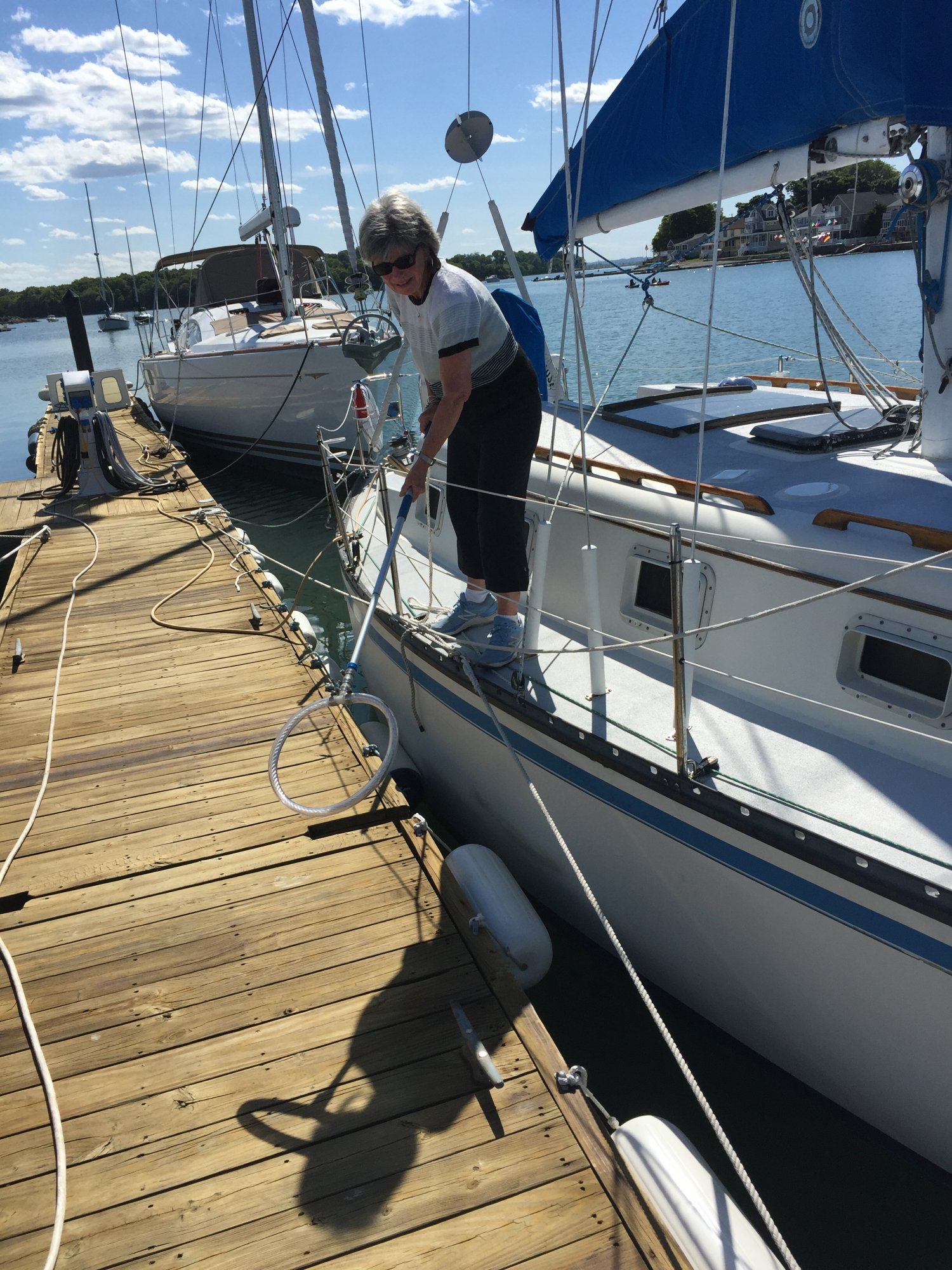

We use what I call a "No Jump Cleat Snagger." Wife lately refuses to jump to dock with mid-ship spring line in her teeth. Had to invent the snagger. It is an expandable aluminum pole with the spring line running through the pole. On the end is an eye splice held in a loop by a clear PVC hose. "No Jump Wife" attaches spring line to mid-ship cleat and stands ready to snag the cleat at the end of the slip as I slowly drive the boat into our slip. Once the cleat is snagged and the boat brings it into tension wife lets it go and the boat lays along the dock in power at idle. She then steps onto the dock and connects the rest of the dock lines. Lastly we replace the snagger with a regular dock line and open the victory beers.

Also similar to the “Docking Stick” that Patrick Laine uses -
But in the OP’s case we’re talking about coming back to a home slip, not a visiting slip. In this case I don’t think there’s any reason to take the lines off the dock. Just leave everything at the dock and pick up the lines with a boat hook on the way in. No lasso-ing, jumping to the dock, etc.

But I still like the "No jump, dock snagger". Now that I've seen this with the clear plastic hose holding the loop open, I'll make one for docking, at other than the home slip. At the age of 81, I need all the help I can rig up.

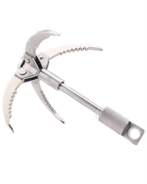

And it can be adapted to snaging the wooden bullards used in BC only there a mini grappling hook is employed.
