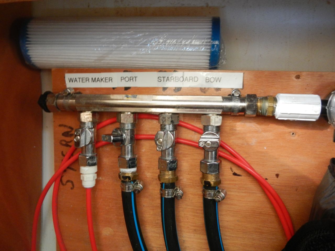

No, you are going to want to be able to isolate the two tanks. You don't want the water to transfer. This means you're going to need a manifold with a T-valve on each of the inputs from the tanks, being drawn on from a common output that is attached to the pump.
This picture shows more than two tank inputs, but you get the general idea. This should not be below the level of the tanks, it's better if it's above.

I would want to be able to isolate the tanks from each other so
1 You can fill one tank and then the other - assuming the fill would be much quicker than the cross draining and you want to get them full one at a time
2 If they are on opposite sides you don't want one draining to the other when heeled
3 They are independent and one is a reserve for the other.
