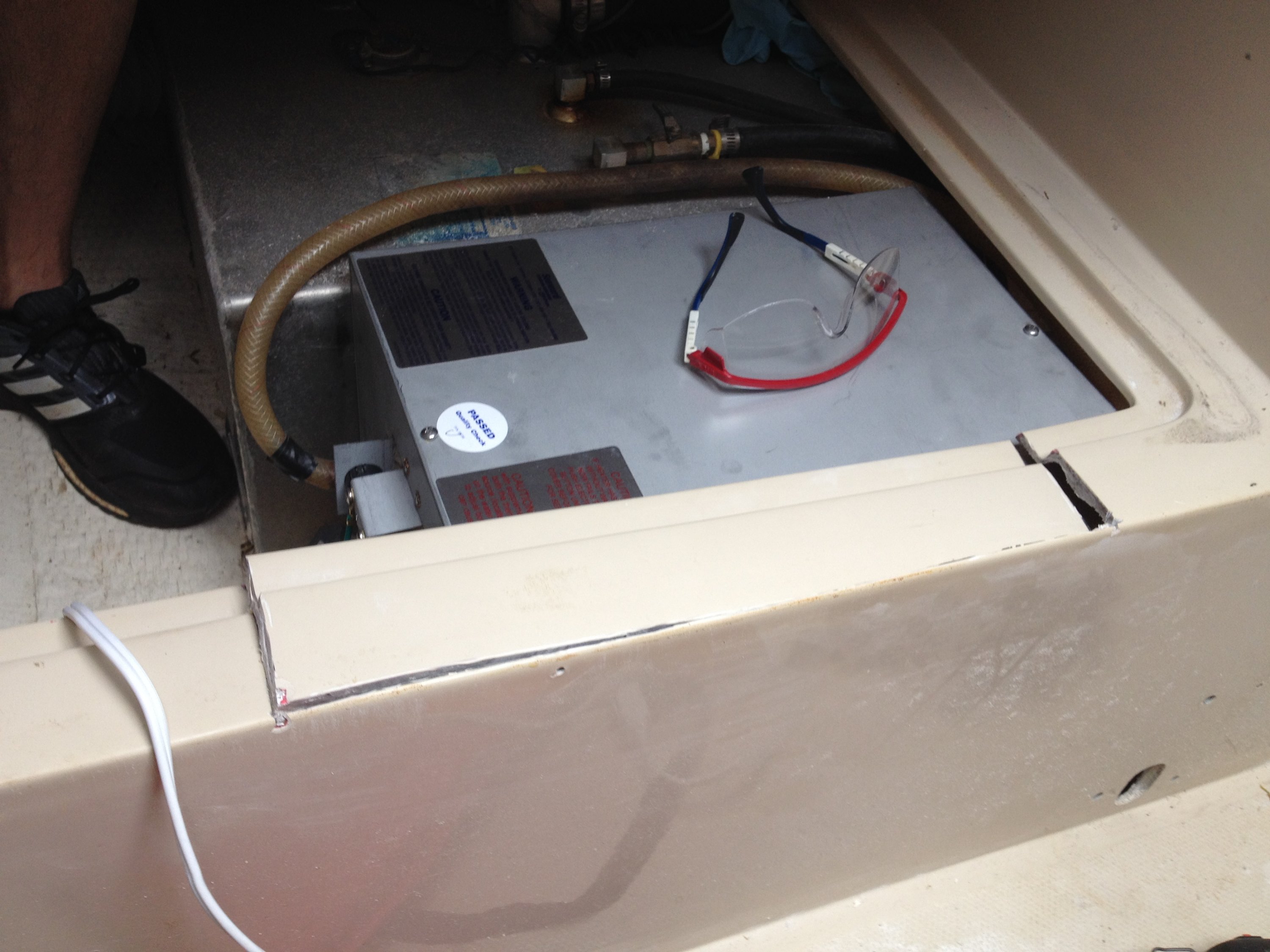

That "rotten egg" smell is just sulfur bacteria that has built up in the heater and easy to remedy by simply flushing the heating unit out several times. Good to get in the habit of running your hot water on occasion. Simply let your hot water run for awhile, recharge and do it again! I wanted hot water for showering and washing and opted to replace my heater despite the difficulties of removal. As discussed in other threads I had to cut fiberglass to remove it and replace it, while others found it easy to wiggle out toward the galley side.

If by chance you have to replace your water heater and you cannot slip it backwards through the drawer unit, here is what you end up doing. Cutting fiberglass to get it out and back in! Bob.
How did you reinstall this piece after removing it.
