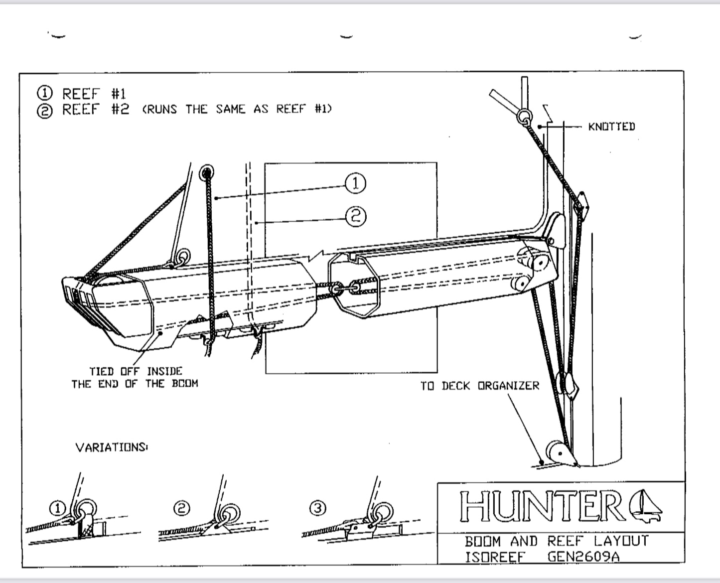

Got diverted to many other projects!! Back on new line for reefing. Does anyone know the line size spec for reefing lines on 42 Passage? I currently have 5/8” on reef#1 and 1/2” on reef#2 on the forward section on line. Both aft sections of #1 & #2 are 5/8”!!! The sheaves on aft end of the boom appear to be 9/16”.
23,387
If the sheaves are 9/16 then you should be looking at 1/2 max. Perhaps 7/16's
Here is the spec on 7/16 :
Double Braid Polyester Yacht Braid - 7/16" Diameter - Made with 100% polyester and braided to produce the best quality low stretch rope available anywhere. Our torque balanced braid ensures maximum tensile strength and excellent abrasion resistance. Idea for halyards, sheets, guys and control lines where strength and low stretch are required.
Tensile Strength 6,600 pounds or 2,996 KGS, Weight 6.4 Pounds per 100 feet
