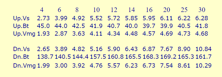

raw numbers.
Twind 4 6 8 10 12 14 16 20 25 30
Up.Vs 2.73 3.99 4.92 5.52 5.72 5.85 5.95 6.11 6.22 6.28
Up.Bt 45.0 44.0 42.5 41.9 40.7 40.0 39.7 39.9 40.5 41.8
Up.Vmg 1.93 2.87 3.63 4.11 4.34 4.48 4.57 4.69 4.73 4.68
Dn.Vs 2.65 3.89 4.82 5.16 5.90 6.43 6.87 7.67 8.90 10.84
Dn.Bt 138 140 144 157 161 165 168 169 165 161
Dn.Vmg 1.99 3.00 3.92 4.76 5.57 6.23 6.73 7.54 8.61 10.2
For any Twind speed
Up.Vs boatspeed
Up.Bt Twind angle
Up.VMg VMG
same down.
The numbers assume:
1 lightship displacement + crew
2 clean bottom
3 folding prop
4 good sails
5 good trim
6 good driving
anything less and then you have to start to fudge. And it means spin downwind.
The BEST way for a learning crew to use polars is to focus on: target:
BOATSPEED upwind
TWIND ANGLE down.
Than means that if you know true wind is say 10 knots, your target is 5.52 knots. If you are slower you are pinching (or 1-6). If you are faster you are footing, no two ways about it!
Downwind sail to the true wind angle. Easy.

Jackdaw, that is a lot to digest but I am working on it. I do understand your point about using boatspeed for the upwind target but please help me with the downwind target? Ultimately we have decent factory sails but are pretty heavy (because we cruise her also) and we do not have a folding prop so I will use the wind angle to help get us in the right neighborhood -Light winds 44-45 and heavy winds 39-41.
Can you clarify the sail to the true wind angle statement? Are you saying that we pick the angle from the chart for our windspeed and focus on staying on it? Are you using true wind angle in this case because the apparents are so hard to keep track of when going downwind?
