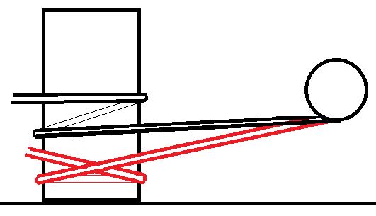

I don't have self-tailers and frequently encounter this problem on tacks: I throw two or three wraps on the winch and pull the sheet in rapidly hand-over-hand; the sheet "walks" its way down the winch drum such that the angle from the fair lead causes the sheet to cross over itself on the drum and jam. I then have to take the turns off the winch counter-clockwise to clear the jam, quite difficult if the sheet is under tension. Annoying, and I have missed stays quite a few times due to luffing up to relieve the tension on the sheet to unjam it.
I tried to illustrate in the accompanying drawing - black shows the proper wrap with the tail coming off on top and the sheet from the fairlead coming in on the bottom; red shows the sheet wrapped over the tail.
How can I avoid doing this?

I've encountered this with both self-trailers and non-self-tailors. Unless you somehow have your fair lead located high in relation to the winch drum, which I doubt, I think the issue is the inherently inconsistent tension on the sheet as you are pulling it hand over hand while the head-sail moves across the fore deck. It allows the multiple wraps around the winch to fall over one another. Try starting with just one wrap around the winch until the sail begins to pick up load, then quickly add two more wraps above the first.

We use the one turn first method. We also have a block at the toe rail that sets the sheet a a good angle to prevent the override. You might try installing one if you haven't already and experimenting with the angle.

This from the Harken folks:
Line Entry Angle is Important
Winches are further affected by how they are mounted on the boat. The most important factor is to ensure a proper line entry angle. Lines must lead up to a winch at about a 5-to-8-degree angle to prevent overrides of the sheet on the drum. If lead blocks are too high to allow this angle up to the drum, the winch must be raised slightly, or you will have serious problems preventing overrides.

You can either install a fair-lead to lower the entry angle of the line to the winch or put a wedge under the winch to "tilt" it backward. Only need a few degrees. See diagram from kloudie1.
There is another options such as installing a turning block stern of the winch. Most slope with 150% genoa need a turning block and adjustable fair-lead track.

Claude called it. Your picture show an impossibly bad angle. If the lead-in comes from ABOVE the winch (even by a few degrees) over-rides will be a constant (and very dangerous) problem.

Taking a second look at your diagram today, I see that Kloudie and JackDaw are absolutely right. The entry angle from the fairlead is indeed too high and will cause overrides.

Thanks for all the replies and great advice! I was out today and practiced the one-turn-then-add-wraps technique. A great improvement in tacking, and no overrides. I also might experiment with adding a block to reduce the angle.
