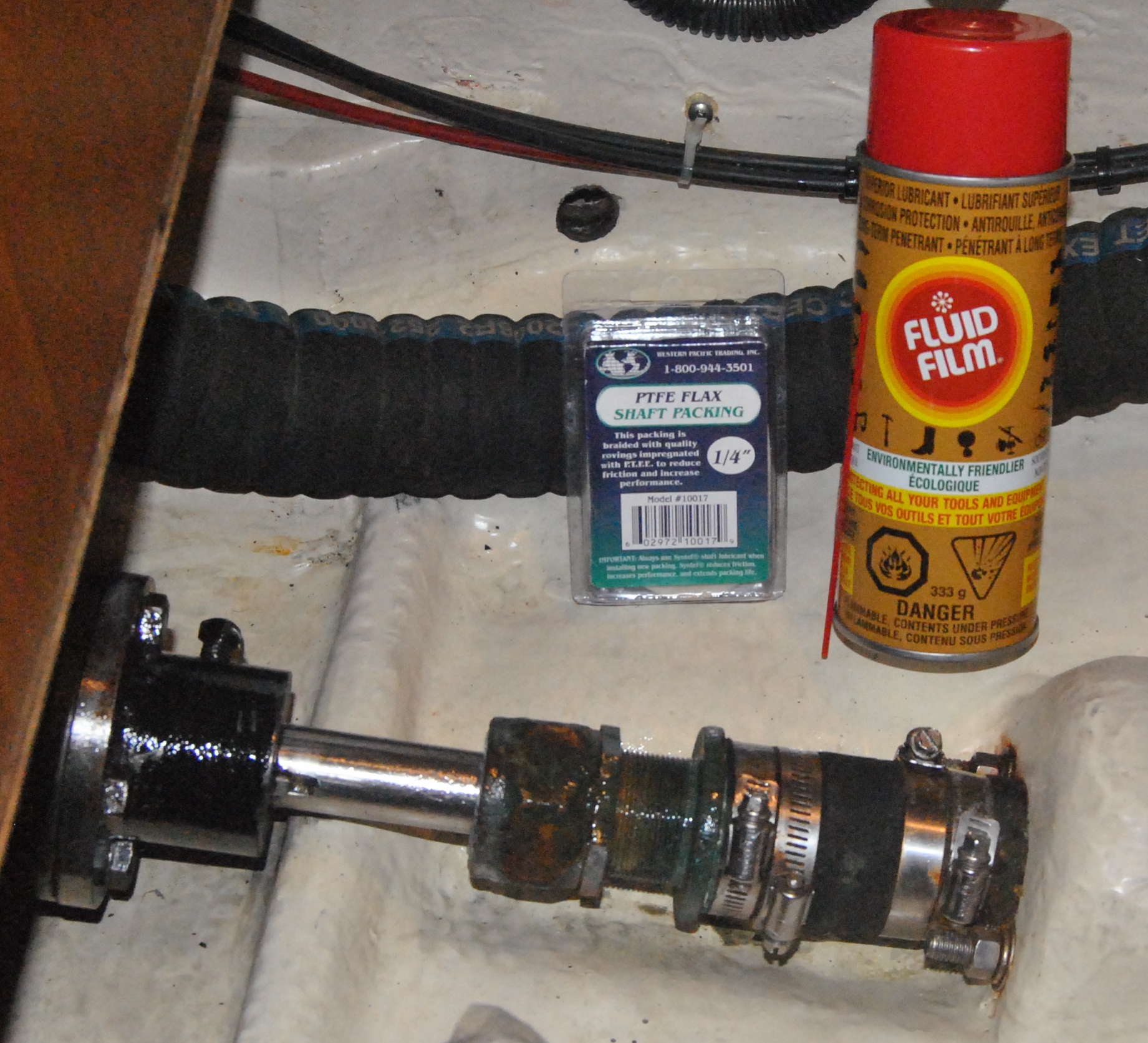

Very nice looking video. I presume you did an alignment job on the newly installed shaft but didn't want to show it in the video if your language is anything like mine when doing an alignment job. Your video would have immediately become XXXXXX rated.
How's the GFO working out after the repack ? I've had excellent results with teflon impregnated flax and usually get about six years service between changes. And I run my gland DRY at all times.
Rough alignment on the stands, and final once the boat was in the water.
I like the GFO packing and it is holding up fine.
