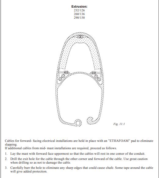

It appears that there are possible cables which run up the front of the mast, between the front edge of the mast and the internal foam installed to prevent the cable from slapping inside the mast. Are you planning on using a spinnaker pole with a symmetrical spinnaker? You may want to consult with a Selden rep before you do this, just to be certain that's OK.
