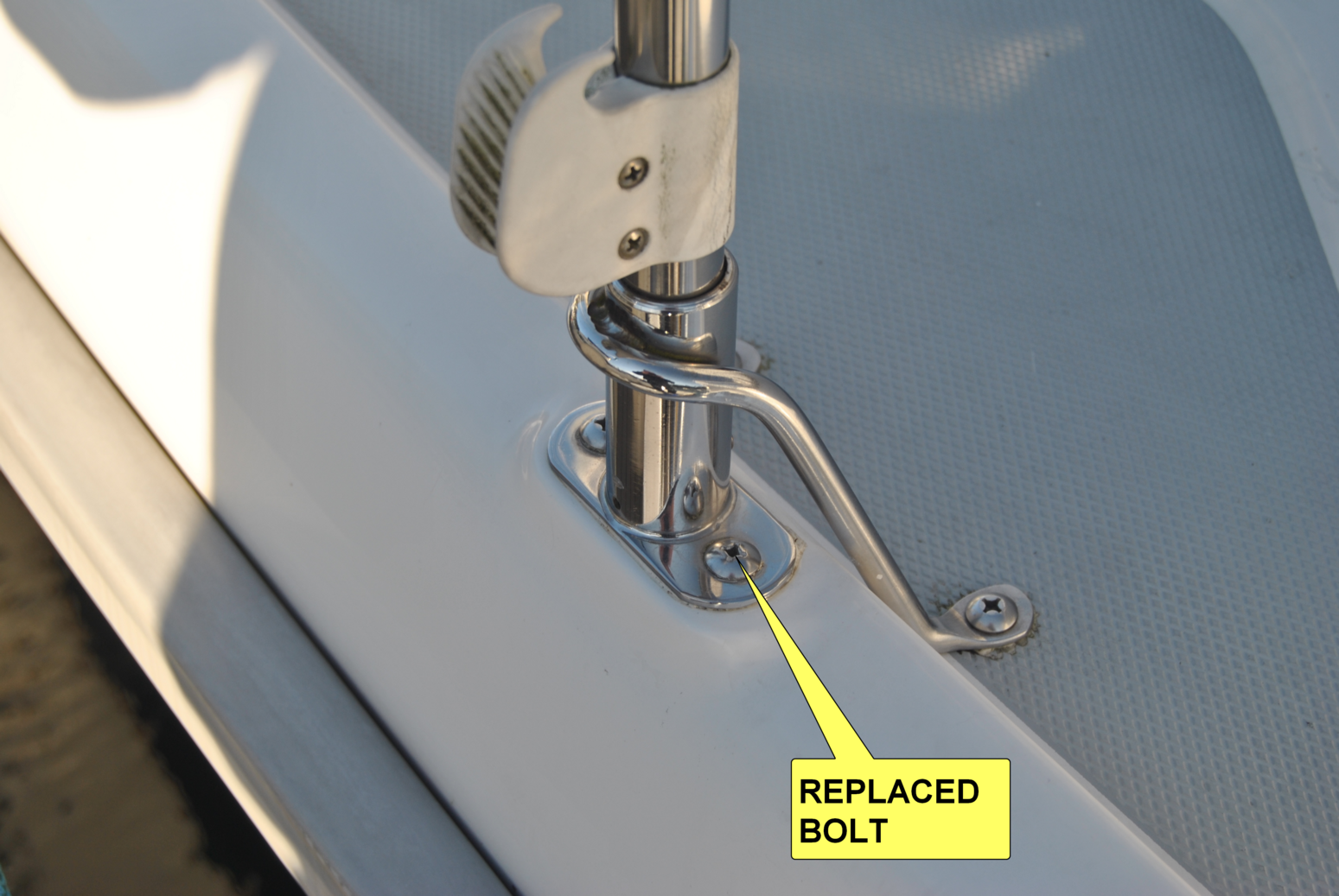

I would most strongly suggest you determine the method of attachment to the deck before doing too much damage on the inside of the boat. I have removed one of the cleats which was afixed to the toe rail and its bolt was definitely threaded through an aluminum plate. I cleaned the threads with a chaser tap before re-attaching the cleat. I believe Hunter Marlow was using this method on deck hardware right up unti their last boat came out of production.

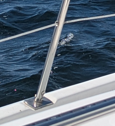

On my boat, there are no bolt heads visible on top of the stanchion plate, which is stainless steel, not aluminum. The plate has a short (~2" in length) stainless steel tube welded to it, over which the stanchion is attached with a bolt and nut, going through both, and another screw above it, as seen in the picture attached. So unless there is a bolt inside the tubular part of the stanchion base, there must be some threaded rods welded to the bottom of the stanchion base. The stanchion in question is in the middle of the boat length, but another one, just forward of the mast, looks identical. The mounting of it from inside can be seen, albeit not easily, through the opening over the v-berth, which can be removed. It seems this one is mounted with four nuts on threaded rods that go through the deck. It makes sense since two bolts would likely require additional support for stiffness, like I see in your picture.
In the Spring, i will check if there is any bolt inside the tubular part of the stanchion base, but even if so, I will likely need to get to the bottom part of the mounting (pun intended).

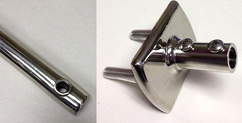

Ok.. Suprisingly not all Hunters boats used the exact same stanchion.,
Here is the link to the one I think you may have.
Stanchion And Base, 24 In, 2004-present
Yes, I see. It looks as if you likely have threaded SS rods going through the plate and as you've seen :
The buried and threaded aluminum plate has more than a few disadvantages as opposed to the use of nuts on the protruding bolts. If you do have a bolt come loose for whatever reason, and the SS bolt is galled inside the aluminum plate (about 50/50 chance), you have a nightmare of a job to install nuts on the new SS bolts where they come through.
