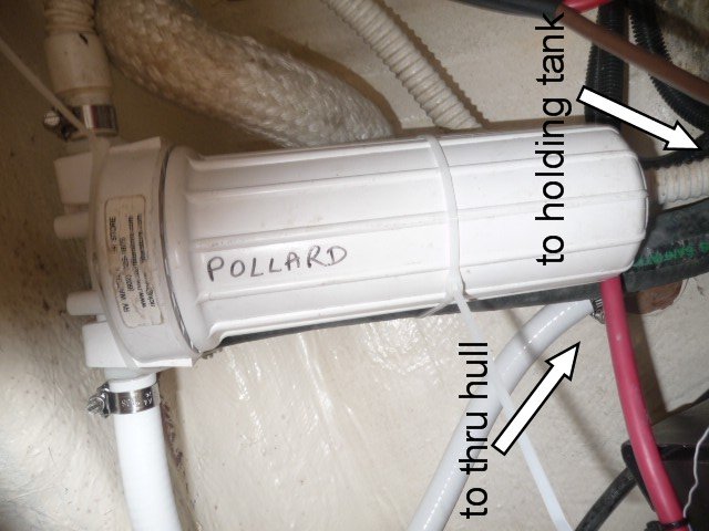

Well after many an embarrassing smell from my holding tank vent when the toilet was flushed knocking people over on my dock I installed a carbon filter and now NO SMELL!
A fellow boater mentioned that he made a homemade carbon filter using aquarium charcoal and pvc piping I decided that maybe I would do the same. Then I came across a old water filter that used 10 inch cartridges, so I thought why not?
I bought a granular carbon 10 inch filter put ¾ inch pipe connectors to fit in the filter. I then disconnected the holding tank vent (3/4”) hose where it goes to the through hull fitting. I connected it to the input of the filter container. I added 2 ft of ¾ inch hose from the output of the filter container to the through hull fitting. It is done. There is lots of height that no heel will ever allow fluid into the filter.
I tested it before installation (wow what a smell) and then after and (no smell) nothing, absolutely nothing. In fact I thought that maybe it was plugged so I sucked air out of the end of the clean new hose and there was lots of air moving and you know....even the air tasted sweet. :)

Thank you for your comments. Actually, the old vent line had a big loop that went up above the through hull fitting and then back down to the through hull fitting to complete its passage. The new filter does not really change this loop, just the filter at the top of the loop. Air flows both ways through the filter and there should be no increase in resistance to this unless it gets wet. I agree. I plan to change it every 2 months or so whether it needs it or not.
I know, Peggie says get rid of it and I guess go back to the smell. My buddy has had his for 3 years and no problem. Maybe I am wrong. But I am going to try it. I do not think it will impede oxygen into the tank much more than with out the filter.
Hunter installed my vent with a loop so the loop is still there. Really, it is just carbon soaking up the smell, air still moves back and forth. Hmmmm....
I will get a photo and post it. Very simple. If it does not work, it is simple to pull out.l

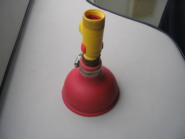

Peggy, can you tell me exactly how to backflush the vent line.....sorry, just not getting that one! Thank you!
Dec 2, 1997
9,011
- - LIttle Rock
LuzSD;823544Peggy said:

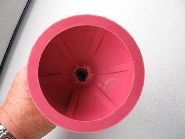

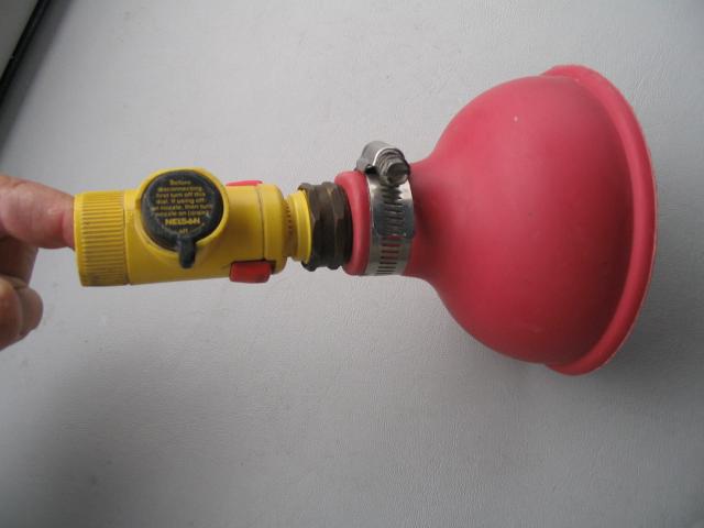

Stick a hose nozzle up against the vent thru-hull and turn on the water! :dance:
However, because "vent " thru-hulls are all only 5/8" and actually designed to use on fuel tanks, many of 'em have screens or tiny pinholes...or worse yet, if your boat is a Catalina there is no vent thru-hull, just a slit in a rail stanchion (in which case, scraping out the slit with a screwdriver blade is about the only way to keep it from becoming blocked)--that's not as easy as it sounds. Those types of vent thru-hull are also the MAJOR cause of holding tank odor, 'cuz they allow NO air exchange through the vent.
The solution: replace the thru-hull--or on a Catalina, install a thru-hull--with the type in the attached photo. And as long as you're doing that much, increase the size of the vent to 1".
NOW all you have to do is stick a nozzle up against the thru-hull and turn on the water. Do it every time you pump out and/or wash the boat and you'll never have to deal with the consequences of a blocked vent.

What does your thru-hull look like, Rick? Can you email me some photos that show what you've done in enough detail to let someone else build one? And the thru-hull fitting.
