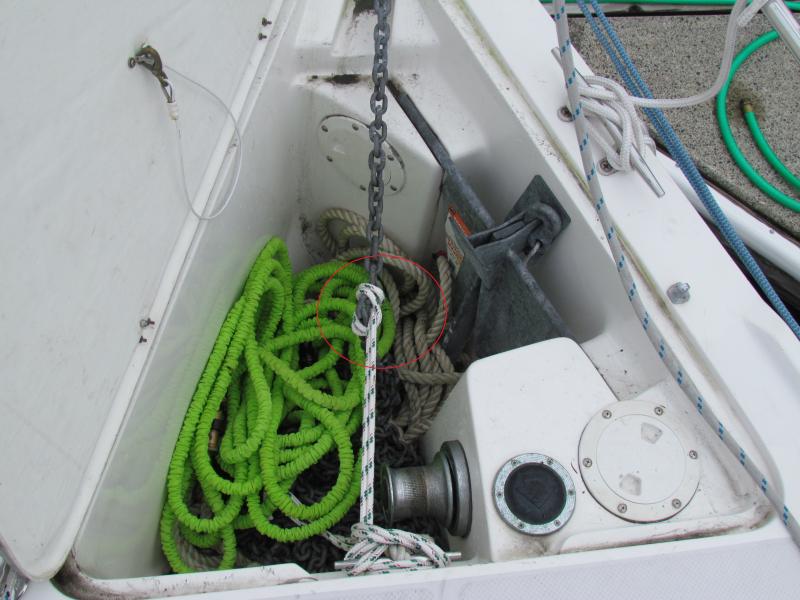

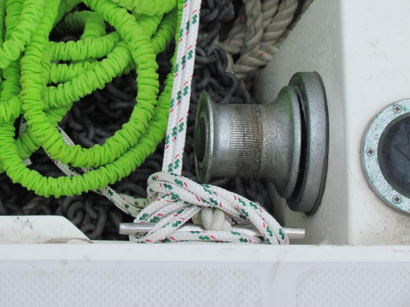

(From memory, the boat is new to me and I've only anchored once this season) I have the chain so that a the horn of the chain passes through a link, then the chain is looped around the cleat, then I have a line tied with a cleat hitch so that the chain cannot come off the cleat unless the line is removed first. If I can remember this weekend I'll take some photos.

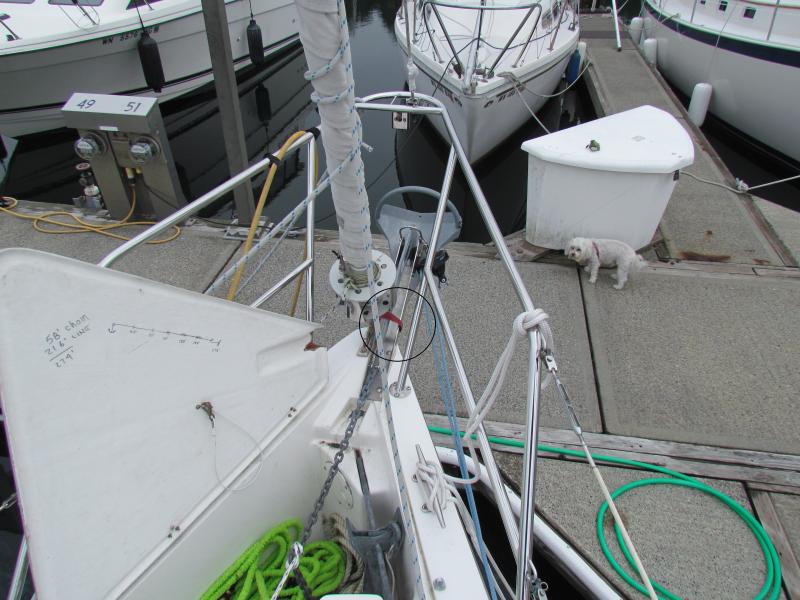

This is how I secure my anchor.
Use velcrow around the anchor shaft to eliminate rattle.
http://www.animatedknots.com/prusik/
I use to use a hook like Stu shows, until in high , ruff seas coming over bow
knocked the anchor loose.
paulj :troll:
