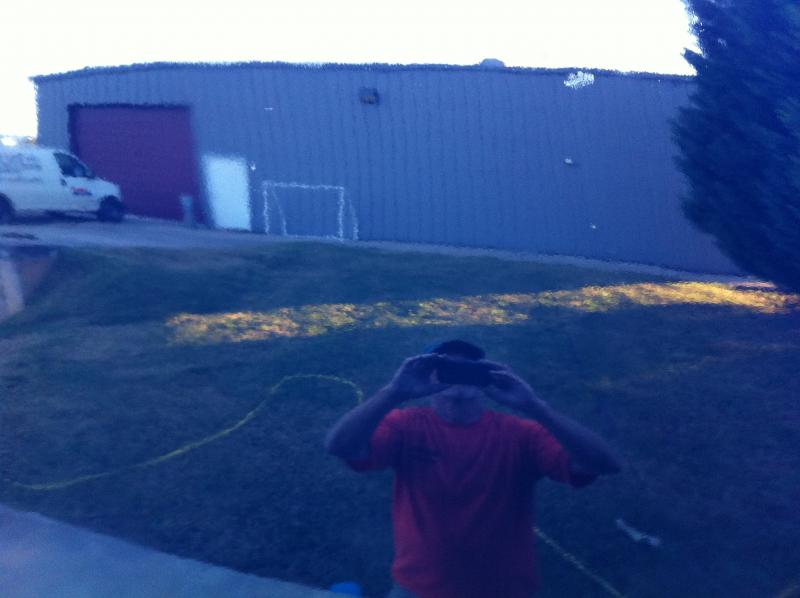

how do you plan on applying the paint will determine it ....are you going to use a primer for the base coat.... ,if you use a primer use a dark grey instead of light grey..... if you spray plan on 1 and 1/2 gallons as the coverage they say on the can is never enough if polling it you may get by with a little less...but i have always found that if you dont do this everyday its better to not try to get full coverage out of their recommendations get a little more ...also study the directions on the paint product can before using it and take the information seriously
i posted a photo of me taking a photo of the paint just after i had applied it by spraying .....what you are seeing is the reflection of me in the fresh paint...

Thanks for the advice guys. I'll get some measurements this weekend to determine how much paint to get. As for the possibility of to much gloss, for me that is impossible. I want my boat to be as shiny and as glossy as possible. So shiny that people need sunglasses to look at it. And your paint looks great Woodster, so smooth and glossy. It doesn't even look like paint, but rather a blue filter you put over your camera. I hope my paint turns out like that when I am done.
