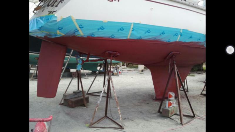

I'm having my bottom taken down to the Gel-coat so I'm going to need both barrier and bottom paint. The painter is planning to do 3 coats of barrier and 3 coats of bottom paint plus a 4th coat at the waterline. My question is how many gallons of each should I plan on and is it normal to put on 3 coats of the barrier paint?
Thanks.. Jon

It has normally taken one gallon of bottom paint to do the hull, and a quart to do the keel. Multiply these amounts by the number of coats you plan to put on your boat to arrive at a total amount and cost.

I purchased 3 gallons of Trinidad. I used an airless sprayer.two coats.three at waterline. Used 2 &1/2 gallons.

That includes everything below waterline. Spraying uses more material. But it is super quick and smoother.

Your first coat of barrier paint ( I used Interlux 2000) will take a bit more than 1 US gal. Subsequent coats a bit less. Put on 4 coats over all - hull and keel- plus an extra 1 on the rudder. I used 4 gal. I would recommend at least 3 of the barrier coat. I use VC17 so only on coat because I was only in the water for 3 months then out for the winter. Added another coast of VC17 this spring

Based on the great feed back... I think I'm going with 3 for the Barrier...The Interlux sounds fine for this and 3 full coats + 1 waterline coat for the Paint. -Jon

Put a different color paint on as your first coat over the barrier coat (blue over red base or red over blue base) so you will know when your additional coats have abalated off and need to be repainted.
The coverage you get will be based on the paint/barrier coat's viscosity and how you apply it. Check with the Mfgr for approx sq footage of coverage.
My calculation is with a brush to cut in the water line and around the keel/hull joint as well as any thru-hulls. Then all further painting is applied by roller. Use one designated for the marine paint you choose or a cheap home-type may fall apart from the paint's solvent vehicle.
