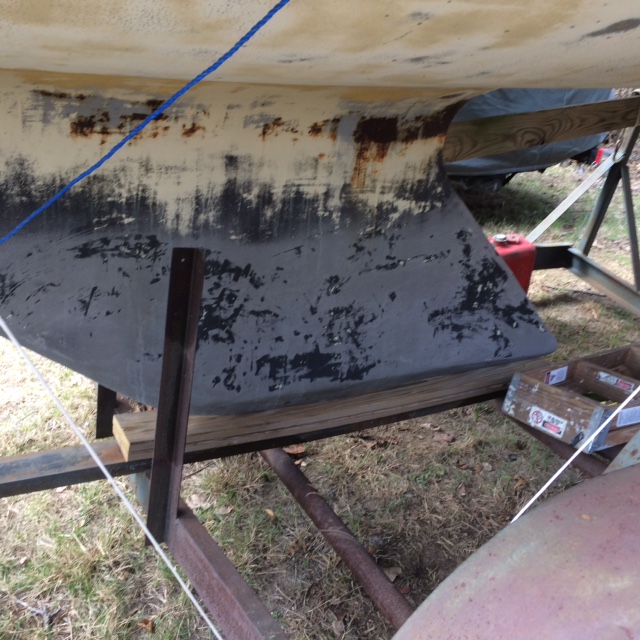

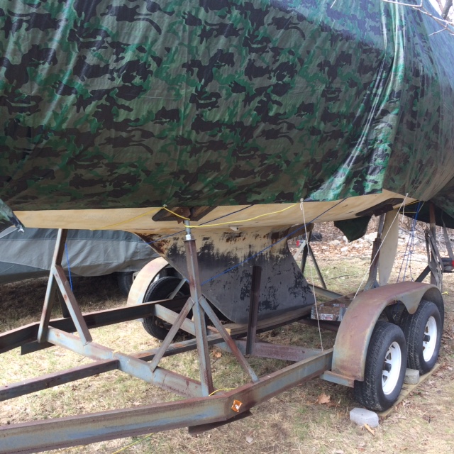

It never ceases to amaze me the willingness of people on this forum to reach out with help.
However, the boat is a Pearson 26 and the trailer was homemade by the PO. It appears to be quite robust except that the planks under the keel had pretty much rotted away. The PO had wedged 2 x 4 blocks between the keel and the support, a section of 3" x 2" steel channel. In order to remove the rotted planks and replace them I raised the entire boat by turning the adjuster nuts on each jack stand one turn at a time until the keel cleared the support sufficiently to replace the planks. I watched for "oil canning" of the hull but didn't see any or hear any scary cracking noises. Once the new 2 X 8 was in place I lowered the jack stands until all the (or as much as I could tell) load was back on the keel as indicated by the ease of turning the adjuster nuts. Now the question is: How much load do I need to put on the jack stand to provide enough "stability"?
PaulK
Dec 1, 2009
1,541
Sabre 402 Southport, CT
You want the jack stands snug so the boat doesn't move around. They're not supposed to support the weight of the boat at all; they're just keeping it from tipping over. Just snugging them up hand tight to just touch should be good. Test by trying to make the boat move and tighten a half turn if it does. Repeat until nothing moves. Then strap the hull down to the trailer frame (fore AND aft) before hitching up. Mast gets tied to the boat but not under the straps that hold the boat down. (Don't want to kink the mast.) Bon voyage!

Not part of the original question but: If you are planning to transport the boat over the road on that trailer you might want to remove the tarp that is over it.

While I agree with all the conventional wisdom above, I just happen to read in my owners manual yesterday that the builder warned against putting too much weight on the keel alone and also recommended that the poppets be in alignment with bulkheads. It does not state how the poppets should be adjusted.
10,536
-na -NA Anywhere USA
If you are going to raise the boat with the jack stands, I suggest four each side to distribute the load on the hull and make sure they are chained side to side or use high strength line. Do enough only so the rotted board can be replaced. Have the new one to fit already made and if bolt holes thru it include that as well. Remove quickly the old board and insert new one aligning holes. Then drop boat back down not leaving it on the stands except supporting sideways. If you feel queasy about doing that or if you feel that the boat could fall, back off quickly. The choice to do this will rest with you but whatever you do, safety first.
Jul 23, 2009
929
Not all boats should have the entire weight of the boat on the keel. I had a San Juan 7.7m and if most, not even all, of the weight was on the keel the hull would oil can at the back edge of the keel. The 7.7m was lightly constructed and I think a P26 would be fine with all its weight on the keel. I add several jack pads to my trailer and adjusted the bunks, that solved my issue.
