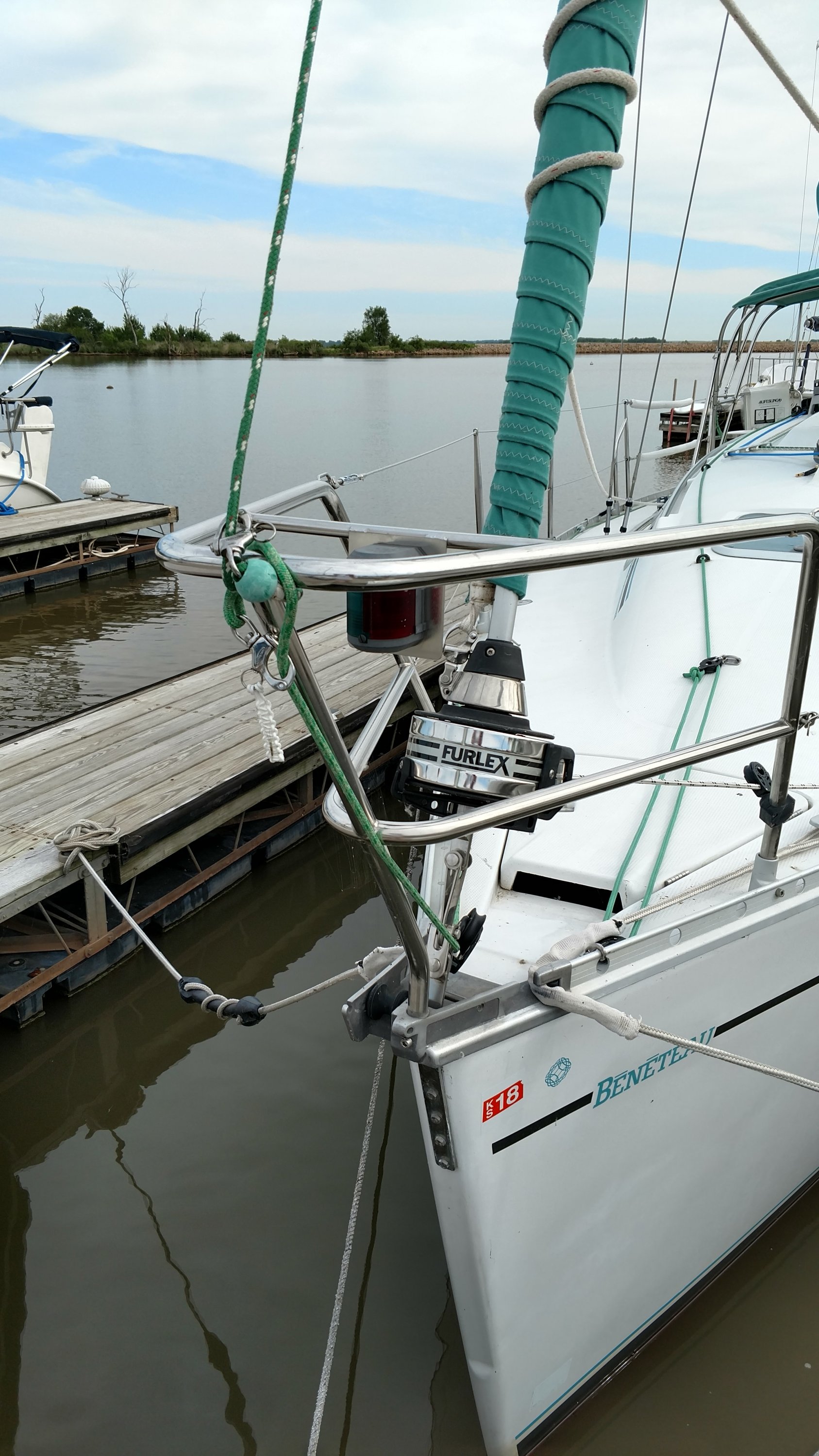

Currently, I tack mine off the anchor roller via a turning block - see the pic. Tack line runs along the toe rail and secures at the back of the boat - identical arrangement as the roller furler line on the other side of the boat. Not the best arrangement and the bow setup will be replaced by a Selden Sprit over the winter that will have their 90 degree fitting with the pole ring bolted to the flat side of the anchor roller - see the pic. I plan to beef up the anchor roller to handle the loads - working on that plan now.
Jibing is a PITA without the sprit but it can be done. You just have to make sure you don't try to pull it through until it has a chance to fully release and fly out in front of the boat or you will be fighting against the bow pulpit and forestay. Would be a slow maneuver if racing. When racing, we fly the symmetrical.

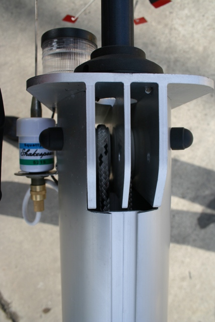

My rigger added an aluminum plate to the mast top with a U bolt on the end of it. A block hangs on the U bolt and this all pushes the top of my Code 0 out about 10" away from the top of the mast for better clearance from the furled genoa on the masthead forestay.
Aug 2, 2010
553
J-Boat J/99 Cobourg
I checked with US Spars about this and they said I should use the sheave immediately above the forestay tang or if I felt I needed to feed from the masthead I should use a diverter (kind of a turning block) no more than 16" above the forestay tang to prevent excessive loads too high on the mast. Given the 15/16ths nature of my rig, I took this with a grain of salt, but in the end I am listening to him.

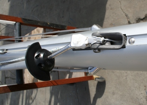

Getinthere has a masthead rig. Had to do something like that.
Likes: danstanford
8,050
Beneteau 323 Annapolis MD
Dan
Dan, I have the OEM spinnaker gear on my B323, and it comes out of the exit block right above the forestay. On my B235 I had a masthead block, and the one and only time I had the spin up, it lifted and the halyard snagged on the windex. I moved the halyard block down closer to the forestay. Unfortunately, I do not have a pic of the forestay attachment AND the spin exit block.

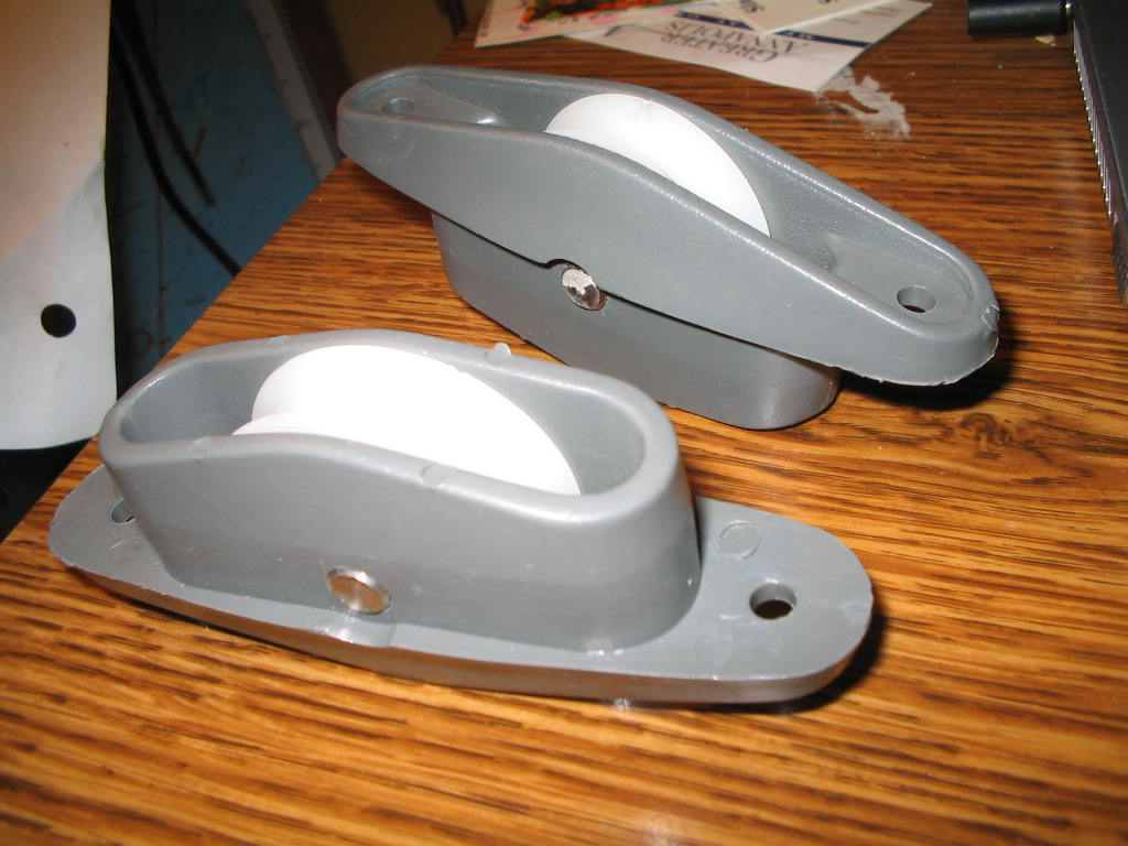

The mast turning block you mention is probably US Spars # 3034. I have two spares if you're in the market. I don't know if Benny has them? Pop rivets were included.
Nov 8, 2010
11,386
I would not trust a sheave attached from the OUTSIDE to hold a headsail halyard, in particular a code sail. Use only in conjunction with a halyard restrainer, or a sheave designed to be mouneted 1/2 inside to spread and support the load.

They actually recommended Part # 3340 but it does look like it fastens on from outside. Ron, I have exactly the same pictures from my own boat so it is good to know I have it straight!

My 310 has that 3034 sheave as OEM setup for the spin halyard FYI.
8,050
They actually recommended Part # 3340 ...
Do you have the numbers transposed(post 16) ? My Z401 mast calls for 3034. I have two in their numbered bag right here. Each one WAS $16.72 a few years ago. By the way, my boom is the Z360.
I don't know who's mast that is in my 2 pics(not mine), Maybe Doug M? Mine does not have that groove down the front, so maybe it is the roller furling one- a Z400E?
Nov 8, 2010
11,386
Huh. I could see that for main, topping lift and spin pole lift, but I would think for a halyard that is pulling OUT it would be sketchy. Most fractional boats will have what I described, but it its working who's to argue??
