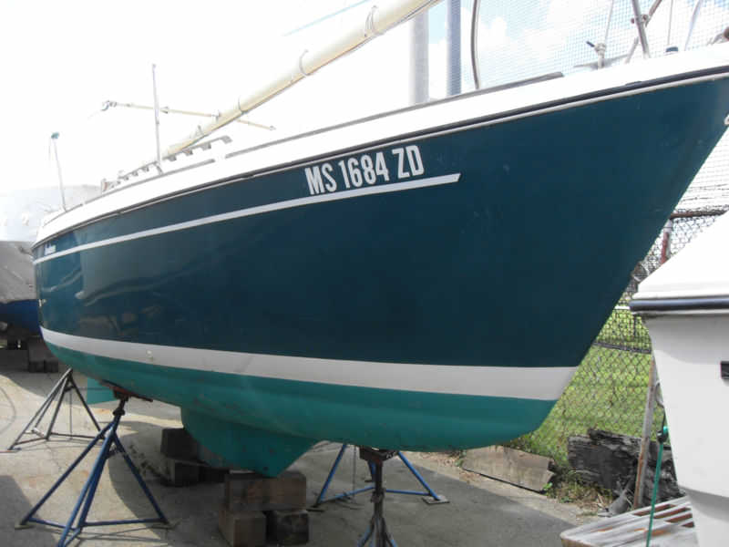

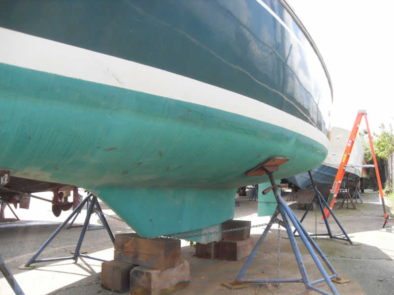

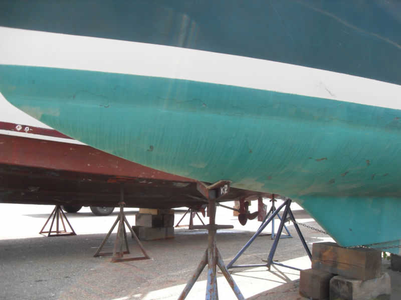

I attached a few pics showing the basic layout for a K/Cb model O'DAY 25, I assume that contrary to your description.... this is what you have?
